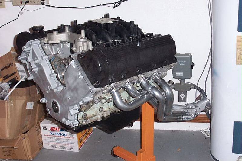

4.6 2V Swap Progress
yeah it is. but not enough to make a difference in my opinion. and I got a really good deal on the engine, trans, ecm and wiring harness.
Only time will tell what we can get out of a NPI ported head.

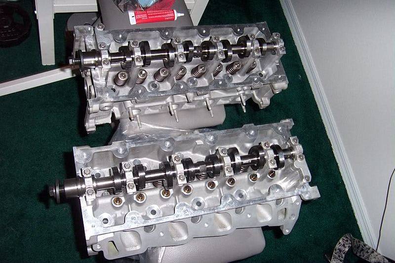

Off the top of your head.....
If you take a stripped down NPI and a PI head and set them next to each other...what's the differences in the two?
I know the port shapes are different. The PI intake manifold is not an exact match to the NPI heads but some port-matching work can be done. Some people just used RTV.
I never looked at my NPI heads much but saw the PI heads through and through while I was putting my aluminum engine together for my Mustang.
I think this is the only pic I have from when I was replacing the valve springs. I believe you're more lift-limited on cams with NPI heads than PIs based on the profiles of the aftermarket offerings for each.
Thanks for the info!
I have heard that about the PI intake and NPI heads. that shouldn't be a huge problem.
The cams will most likely be custom ground no mater what head I end up using so that won't be an issue.
What setup did you build for your mustang?

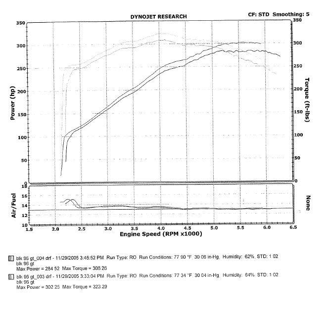

Aviator short block (aluminum 4.6 w/ shallow dish pistons for 32v heads... ~ 90 lb lighter than iron IIRC), stock PI heads, PI intake, VT Stage II cams, Comp Cams valve springs, Thunderbird timing cover (to match the aluminum block & PI heads combo), Cobra oil pan/pump/pickup tube and windage tray, Hooker LT headers (never doing slip-fit again or LTs on an SN95/NE with stock K-member again!), matching X, Dynomax Super Turbos and stock pipes.
It put down 302 RWHP but pinged on stock timing w/ 93-octane gas so my tuner backed off 3 degerees. It still moved but I wanted more so I threw on a Snow Performance Water/Meth injection kit and had it advanced 2 degrees past stock before I sold it and it still wasn't pinging. I tried 2 heat range colder plugs and they helped a little but my baby was an alcoholic.
Here's a pic of it assembled. I call it "MILF":
And the dyno sheet. I realize it's not SAE corrected and the temp for the earlier run is screwy. Lower numbers are -3 degrees timing:
