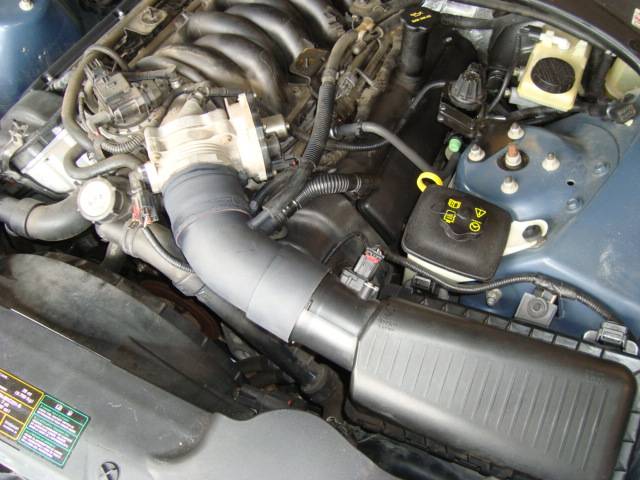

Actually to the OP, your cold air intake is really just screwing up your tune. You should never, ever, ever mount your MAF sensor differently vs. the OEM package without a custom tune. Using a different diameter tubing or even having an excessive bend before the sensor will cause the airflow through the pipe to be different vs. the factory expected setup. On my old '93 Mustang with the Paxton I could rotate the MAF housing in the duct work and see the A/F curve change on my A/F meter.
Here's a pic of my CAI. All I wanted to do was get rid of the leaking baffle pipe.
And I'm with the other guys, until you do an actual mileage check fill up to fill up and miles / gallons of fuel, you have no idea what mileage you are getting.
Your intake idea caught my eye so i followed suit today...
