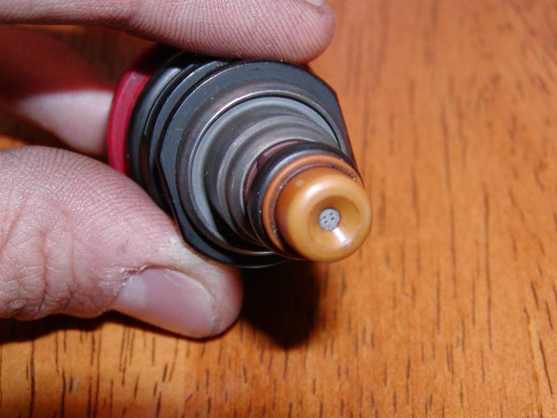

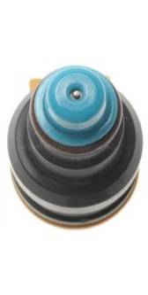

i had to replace some fuel injectors in my car.
they caused a miss, and all around made the car run bad.
pulled the set out of the 69 Cougar, (they are a newer style, better fuel atomization,) and it ran much better.
You put in newer "pencil" injectors? Did you have to change the cars connectors to the injs?
nope. they looked the same. different tip though.
examples
old tips
new tips
