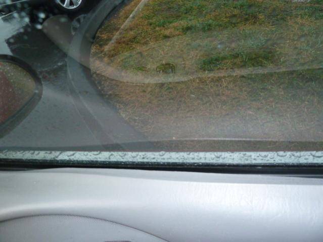

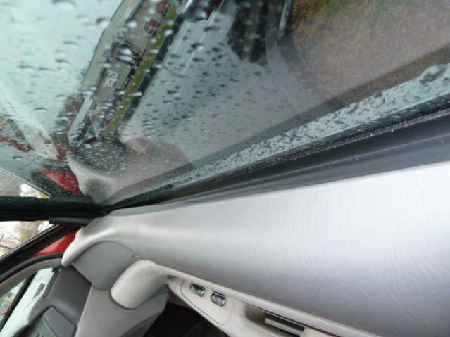

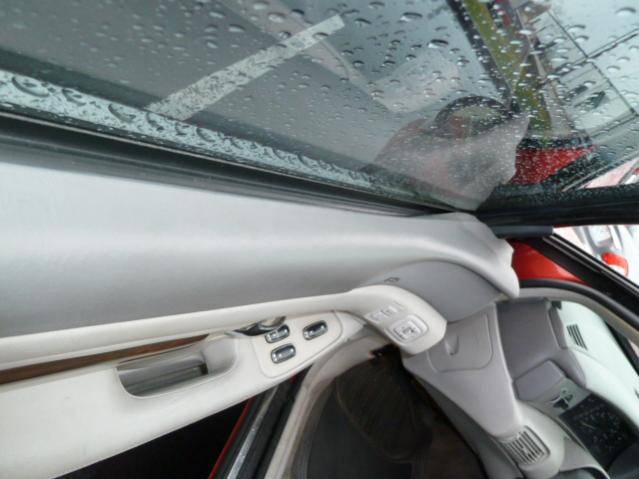

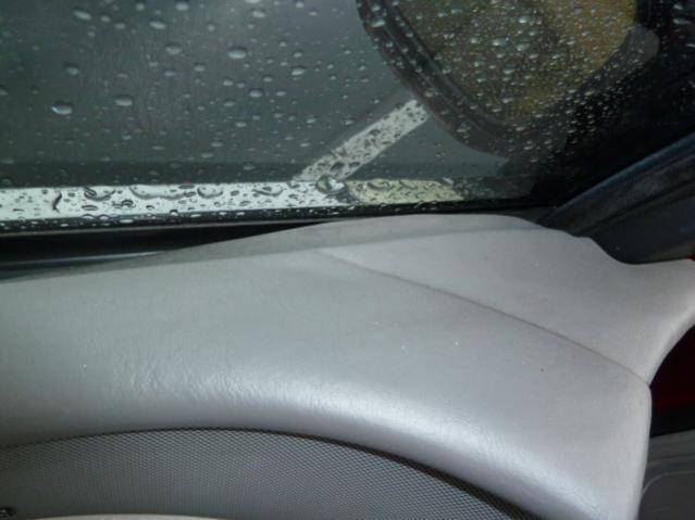

OK, boys...here's the requested pix (sorry for the delay, life got in the way) The first two are of the driver's side, the second two are of the passenger side. I'm still wondering if there is a J-channel that could be used to keep the vinyl panel locked down because, as you can see, the vinyl is lifting already.
I'll have to see about getting a windshield sun shade, but I need to correct the problem before I can prevent it <shrug> Bear in mind, they've recently been reglued with a contact cement (following the instructions, allow it to completely dry then reapply and allow to reach tacky before adhering) so I'm uncertain if glue over glue will give me the end result I'm looking for (but I guess my options are somewhat limited, eh?)
