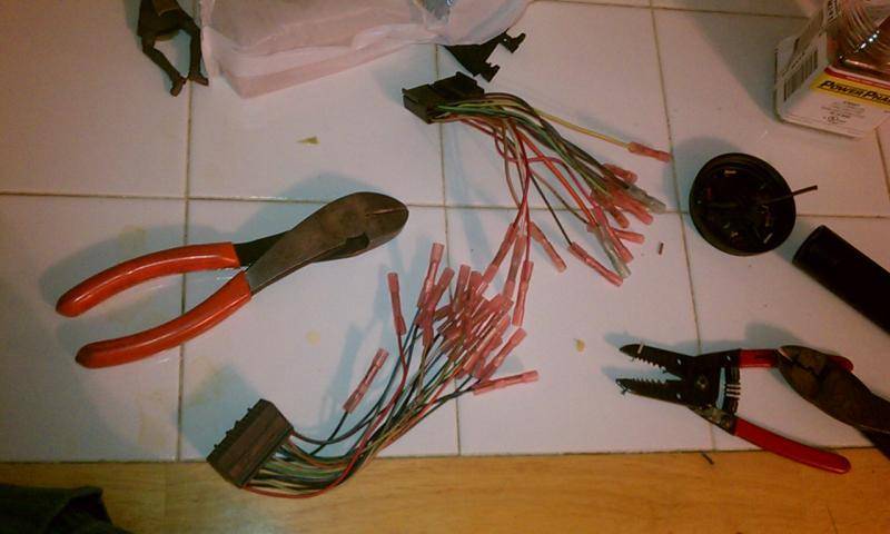

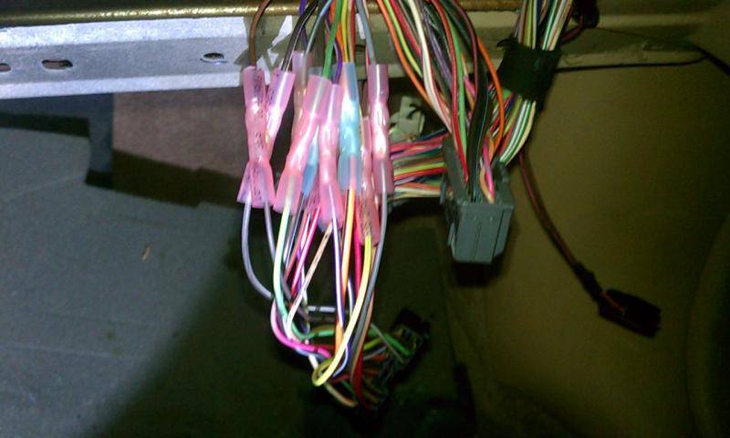

it was late when i got home but i still worked on it a little bit. i butt-connected the 2 replacement plugs up, plugged the scil up, hooked the battery up and crossed my fingers...
ok, i turned on the lights and they all worked, so then i turned the key to see if the car would let me relearn the key, but as soon as i turned the key, the scil made a little click sound and the lights all went out again and still no theft light

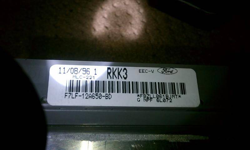

i unhooked the battery again and then unplugged the scil and took of the p/s kick panel and started checking wires and plugs, they all looked great and smelled fine. i went over to the d/s and took the ecm out and smelled it and checked the big plug, it looked and smelled fine. i learned that i have a late 96 model 97... so then i started checking all the other modules and wires out that were in that area and they all looked good too. i pulled the top dash panel off, but didnt see anything really, nothing seemed accesible, so i put it back on... all the wires i looked at looked good, so i just dont see how i could have a short or bare wire anywhere, especially since all the wiring is all nice and snug. does anyone know of any pinch spots for the wiring on the gen 2's anywhere?
