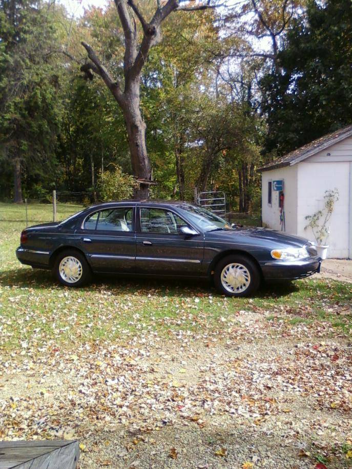

Truly hoping someone can answer this question; my 98 has the rear air ride suspension that is original and works fine, but the shocks in the rear are original as well with over 178,000 miles on them too. I would like to change them but they are the electronic controlled ones that let you select Firm, Normal or Plush ride.
My question is if I just used a regular set of shocks and didn't get the electronic ones you plug in, would my air ride still work? The air springs are separate from the shocks and in theory I would assume that I just would not be able to select the ride quality and basically drive in a default style mode, or does the system require the electronic shocks which are quite expensive, like triple the price of normal base style shocks. Would I harm the system in any way by just unplugging the shocks to see? I certainly am not looking for trouble. Also, if you can do that one would assume that the warning lights would sound every time I turned the car on. Would there be a way to override that function? Any knowledge or suggestions are welcome, thank you much
Nice Conti. I don't think there would be any harm in just taking the connector off from the shocks and see if your air ride still works. That would be the first step I would do to see if it is connected with the air ride system.

Very nice Continental, clean and well kept. :Beer
If I were you, I would buy the second Lincoln for a winter car. Keep this one stored. If its in good shape and had the trans done, you will be good.
