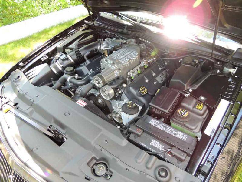

Find one of these.
Not easy to find 400 at the crank.
Nice , C head swap ? I didn't think there was a manifold available to mount that m112 to the B heads .
Full terminator swap done by the best.
Plus 5 speed.
Lets call it a J mod :p
This is a very nice car but if you want performance or the most bang for your buck you do not want that Eaton supercharger.
