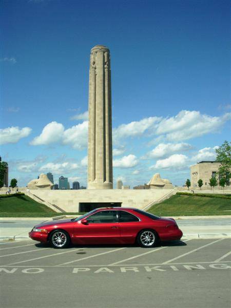

Well, its done. I finally got the trans in, along with new O2 sensors, U-joints, Trans cooler and punched out the first 2 cats. Back in the mid 80's I had a 74 ULTRA-Z (custom camero). It ran low 12's. I bring this up because it also had a stall convertor (3500). I had forgotten about the slippage. I just mean you have to get the R's up for it to get moving, but not bad. It really changes the feel of the car. It flat out lights em up now:burnout: .
Depending on the pavement it will break them loose at about 25 mph on a normal street on the harder tar type streets it will break around 15 mph. I really don't think it's going to cut my 1/4 time much. but now the way it lights em up, it was worth every penny. Next will be the 4.10's, Trac Lok and driveshaft. Really looking forward to that now:hump: . Thanks to everyone who replied to my posts and the advice you all shared.
I also want to say, if you have something to add to someone's post (even if you think it has little meaning). Go ahead and post it, you never know what little points someone might be missing and you just might be the one to clear it up for them.
Thanks again all,:)
Greg:headbang:
