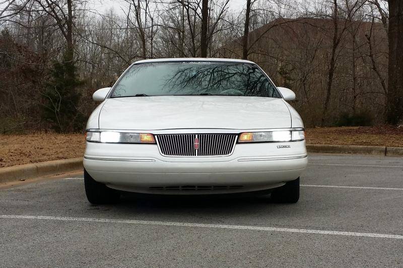

chrome is on the inside of the housings and also how clear the lens itself is, obviously. BTW, the profile pic below is old and I haven't
had HID housings in for years. I need to change that pic. Here is one from February, during the daytime, with just the lows on.

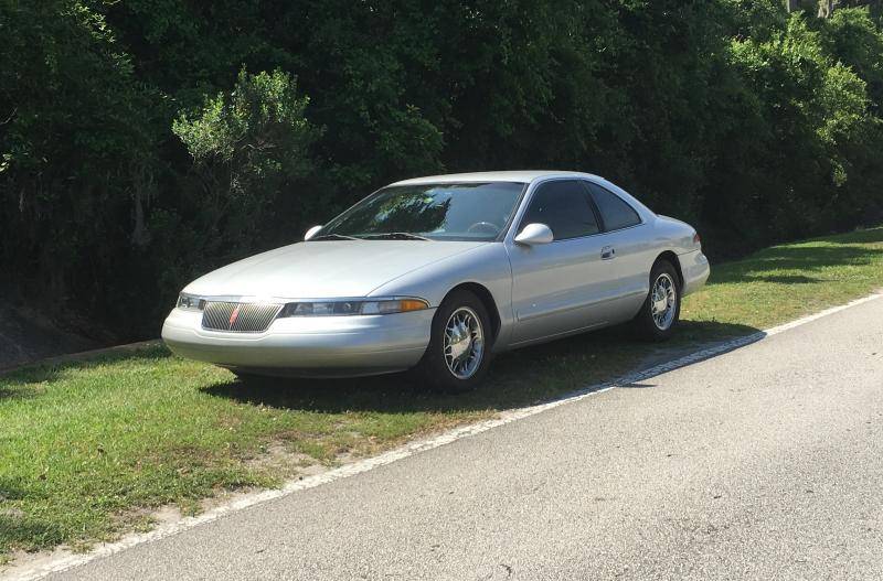

On a side note I wish i would have been able to find spare housings to complete a few projector housings so people wouldn't have this issue but I couldn't really find spares in junkyards. But i'm away at school now so it might be a while before I can make some. But why i'm saying this is because it is possible and can be done and is probably the only long term option that will last the life of the car (unless if you can find great condition headlights). You can see the build thread there: http://www.lincolnvscadillac.com/forum/showthread.php?97078-Gen-I-projector-install
After about 8 months (before I left) they still looked great and I had no issues till then so again it's a viable option. Picture before I left (crappy but the only one i have)
