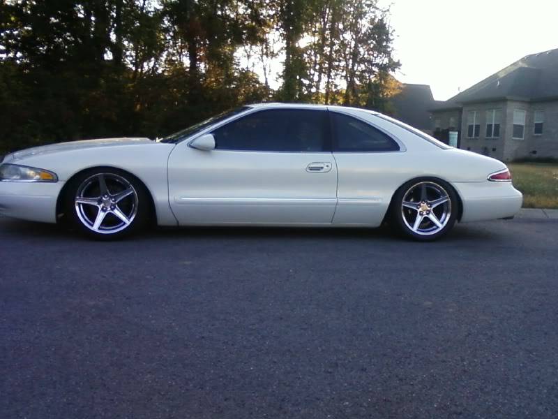

yeah my rear end sits lower than my front.
I have another set of front end struts,and I love working on my car...I fix things that arent broke. lol I want to take the other set (one leaks bad) and go internal and take the bump stops out and cruise on over to a few shows,that way the front end sits lower. Just an idea,prob will never do it though. I'll have to face the problem of exposing more leaks.

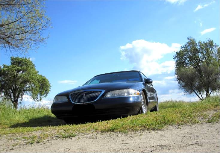

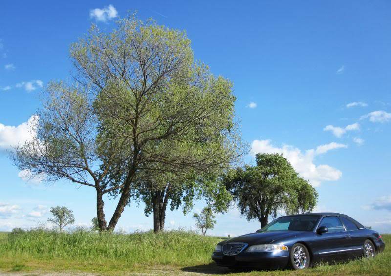

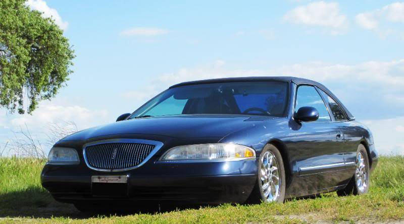

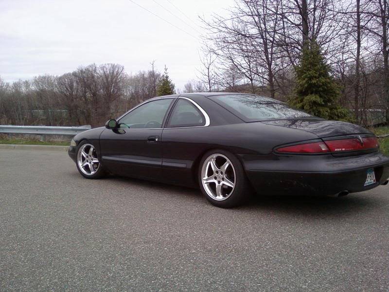

Took my boy fishing this past week, turned and looked back at the car after we parked.. and thought to myself.. "Tribute to Ray pic".
Yea, it's a Base, and has a soft top. It is what it is.
Car was not lowered when we parked, nor is it clean.. didn't intend of taking pics at all. It just happened. Made me wish I had brought my DSLR camera.. It just didn't make sense to bring it on a short fishing trip geared to just make the kid happy. lol
Again, the top will come off soon.. Just not yet, not right now beacuse of money situation. It's starting to show minimal wear, but not enough to bug me. Hope she holds off for a year or 4.
She's as stock as the day my old man bought her.. down to the tint.. which i might add, is starting to bubble.
I'd sure like to replace those damn mouldings though.. Can't stand the look of them. If anyone has some LSC mouldings, holler at me please.
Anyway, Thanks to Adam for the switch.. and everyone else on LVC for all the other stuff I don't know jack about to get her running right... and other things to come. My hat goes off to everyone.
Since Ray's Brother and I are having the same issue, (rear won't vent) I did a sensor lower on the rear.. and use the switch on the fronts. Will get to the sensor lowering for the front soon enough. I don't drive with the Air on anymore, I raise it to the sensor max, and drop the fronts to match the rear. Perfect.
By the way, Air Ride FTW!!!
at least until the damn thing completely fails me. lol!

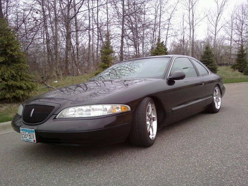

Sorry car is so dirty, its been raining non stop.
Installed switch, shined up the r's.
Rays switch will live on.
