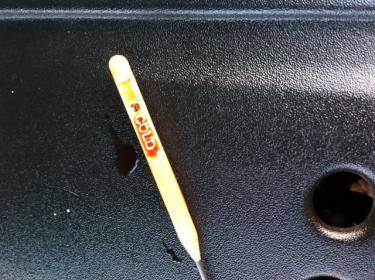

Step one DO NOT GUT THE CATS!!!! You will only create more problems in the future, just replace them as you stated. As for the white smoke I hope it's just trans fluid and not a blown head gasket. How does the oil look? Is there any "peanut butter" in the oil and or coolant?

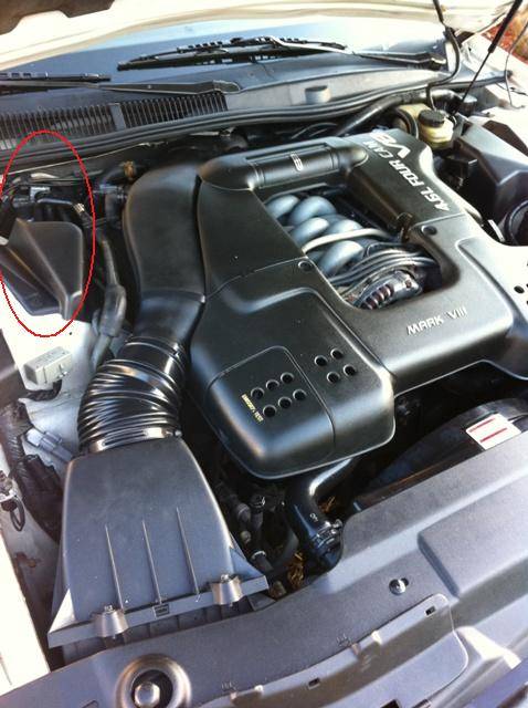

I still don't know where the white smoke coming from because it's not from the cat. It's somewhere between the back of the engine and the wall itself that splits the engine compartment from the interrior. A small hole with an oval shape lets the smoke out thru there.

Car overheated a week ago and I had to change broken belt, water pomp and idler pulley all at once. I completed the coolant reservoir (3 gallons in). Everything was alright until today.
Car start shaking really bad when i was accelerating, it had no power at all to move and a white smoke came out from the back of the engine(not thru the pipes in the back).
