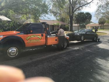

I mentioned reflashing/etc to the service advisor at Lincoln. It's on it's way to the stealership now. So we will see what they say.
depending on how "spongy" the brakes sometimes go... maybe he didn't feel safe driving it over there?

Not a flatbed?? IIRC, the manual states using a flatbed for towing. That CAN'T be good on the transmission...
I do see a dolly under the rear wheels, so they shouldn't be turning and the transmission should be okay. However, I don't like at all the stresses of being towed that way on the body/frame. I would insist on a flatbed too.
I was hoping there would be an answer to this by now.
I can't wrap my head around why you would tow the car that has ABS/AdvanceTrac lights on. I have probably put hundreds of miles on my LS with those lights on, lol.
