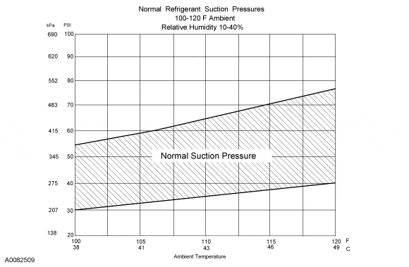

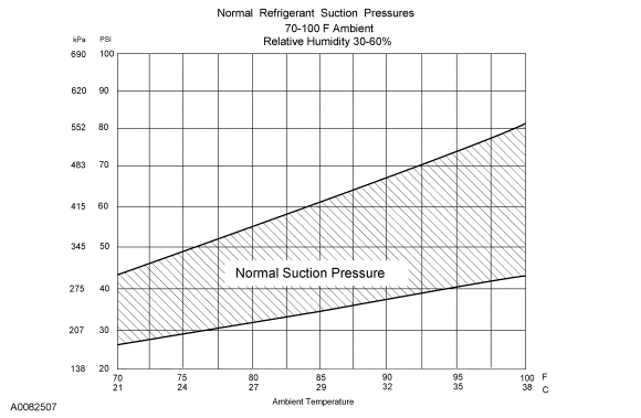

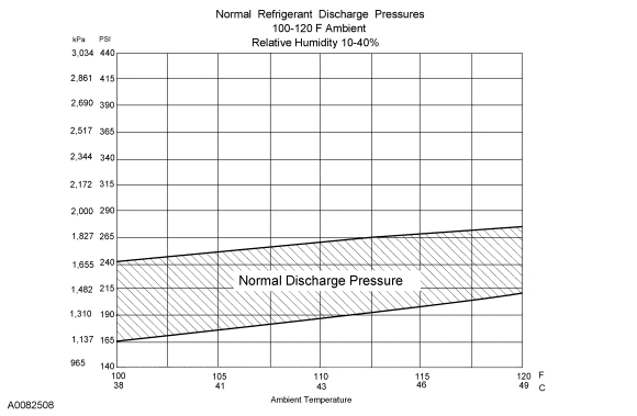

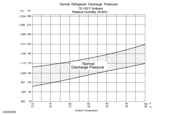

Use High and Low side gauges, put the temperature on minimum, fan on maximum, set to fresh air, and open all the windows. After it stabilizes, then compare the pressures to these charts.
More useful info!
My readings were well within those zones. I'm going to call it good. Thanks again!
