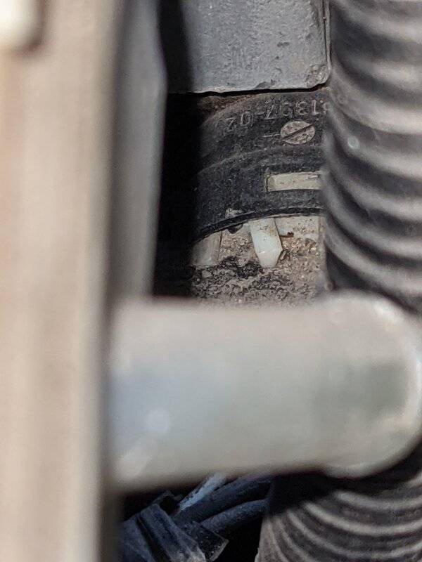

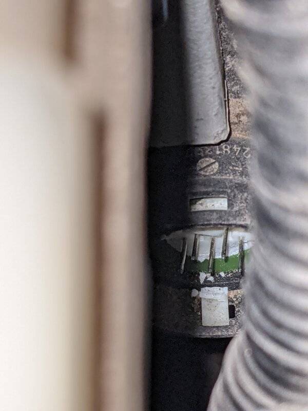

Just pulled the codes and one is set for the ABS module. The code is: C1285 Booster Solenoid Output Failure. Any ideas on that one?

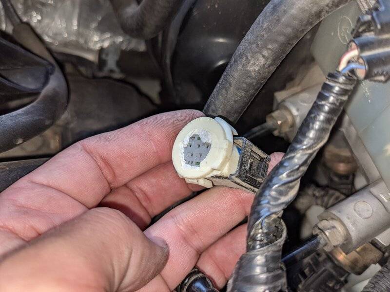

Whelp, found the issue. And the explanation is pure idiot. The tech that did the work broke the power brake booster electrical connector. Not just disconnected, but completely broke it.

Yeah, if they don't want to fix it - and I mean completely replace the power brake booster - then I'll have the credit card company do a charge back for the full amount. And this guy knows he broke the thing, as when I found it, it was jammed back in the socket. What tipped me off was the broken pieces of white plastic sticking out around the connector.
