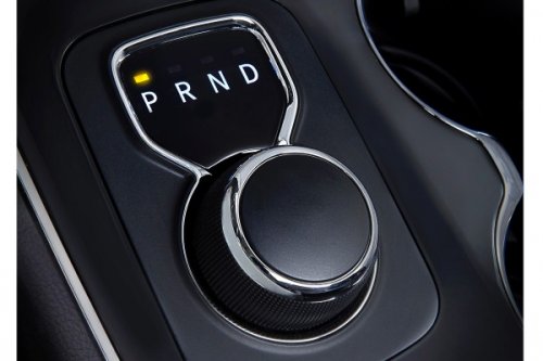

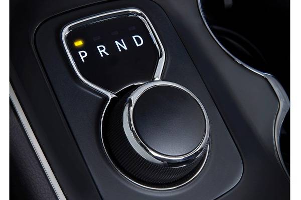

I really hope for the new 2015 that they dont use the same spinning shifter knob the Rams and durangos use, twice now since my dad has traded his charger in for a ram, after starting the car, the knob just spins and doesn't shift any gears, give it 10-20 mins and it will work fine after a restart or two. been to the dealer after both times, and they can't find a problem or replicate it

This is the shifter they are supposed to be using.
that one should be fine, I just don't trust that italian volume knob BS...
