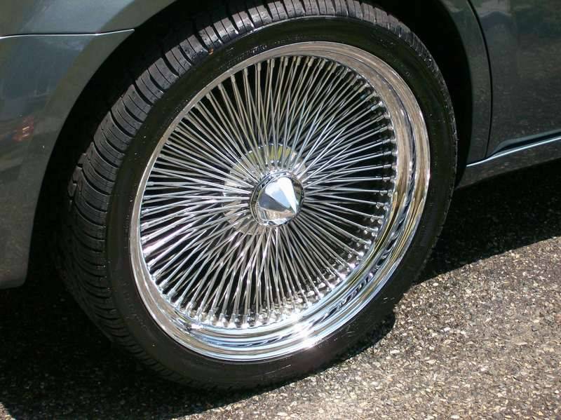

say what you want to say these are the type of daytons i want on mine :cool:
man those are horrible.
They have an adapter that mounts onto the hub. The other daytons you knock the center cap loose and screw it off and the wheel comes out, then you unbolt the adapter off the hub.
Not sure about those. Im guessing that center cap unscrews the same way. So basically the wheels are just screwed on. Not very safe and easy to steal. They are also heavy and can :q:q:q:q up the suspension.
As for wanting a turbo or supercharger, it depends on what you want. But it hasnt been done very often and you can blow the engine. If money isnt an issue you might as well sell it and get an 06 and then do some forced induction. Find a reputable shop and chances are they have never touched this engine so expect some trial and error. And if you do blow it youll need to spend another grand at least on another.
And get some real wheels not those played out 1990 daytons. But you seem to be conflicted, you want a performance sedan or an old school cruiser?
They usually dont have lug nuts. It usea an adapter and they spin on until tight. Then u use a rubber mallet and hand tighten/beat em tight. Then as u ride forward, they are constantly being kept tight. Not the safest wheels out there, but u have to put them on correctly or you'll most likely lose a wheel while driving
