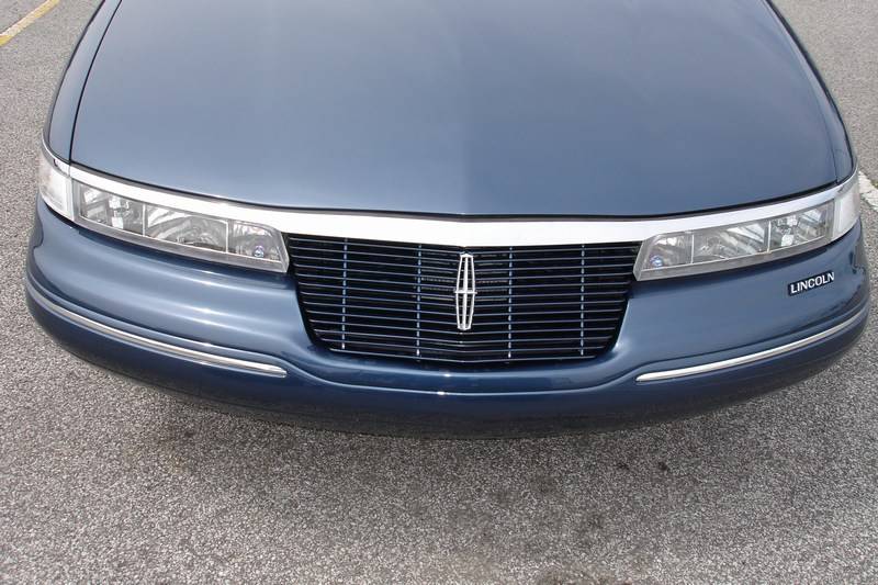

NOTHING else comes close!!!
the waterfall is gone!!!
looks awsome, is it just me or should that lincoln star be dropped down a little so that its centered
Lincolns Own said:
... is it just me or should that lincoln star be dropped down a little so that its centered
Believe it or not, when the bumper/grille was OFF the car at the body shop - it was centered!
Apparently no one(even I) realized the chrome trim overhung the top of the grille assembly. I'm worried if I moved it, it will have a mark above it where it was? :shifty:
