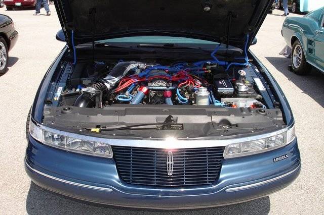

NOTHING else comes close!!!
driller, your car is absolutely beautiful. Out of all the body mods, out of all the colors, out of all the rims, and all the other junk, i truely love yours the best. I especially love how that lincoln emblem looks on there. Do you think youd be willing or able to get another one made up like that?
