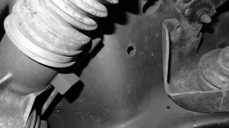

that "3rd" bolt is not TOO hard to get,but if you want to make it easy, a well placed hole drilled in the frame will allow super easy access whenever you need to take the compressor out, i have a hole a little bigger than a 1/4" inch,i push my 1/4" long extension through it, then attach the socket on the end and zip the bolt out like magic(ok not magic,since the logic here is quite simple,but it sure is nice)
just a thought/tip if you want to make life easier with the compressor.
Do you happen to have a picture of the approximate location of the hole that needs to be drilled? This is what I'm going to do, just want to make sure I don't have to drill more then one lol.
sorry, i did not see this request until now
the hole that is almost dead center of photo, hope this makes a good reference point for you
Thanks man, I appreciate the help. I already changed it out, Saturday. I just did it the hard way and turned it tiny bit at a time by hand once I broke it lose. Wasn't fun, but it got the job done.
