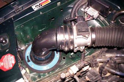

After I did my air ride conversion and removed my air ride compressor, I removed my stock air box. Next I took an adapter for the stock MAF ran some Tubing from the Hardware store to the hole left from the air intake box and resonator and mounted a cone filter below where the air ride compressor use to be.
I should be sucking colder air here.

Which is what just about every Thunderbird intake is like. A very very good design in my opinion.
Thanks, I go the idea from Scott9050 or Torquemonkey back a while ago from TCCOA.com. I showed Jason (02LSE96LSC91SE84TC).... the other day and he liked what I did and felt it should work. My concern is that on real bad rainy days it may be effected by water but we'll cross that road when it comes. If I notice any problems even on a trip it only takes a screw driver to swap it to under the hood as most members have their cone filters.'
This is not a pic of mine but of the one I took the idea.

Any bends before the mass air meter is not good although you will get colder air that way.
Look's good Rich, I like...:D
The gradual bend his has shouldn't be a problem, from what I understand a sharp bend could be a problem before the MAF. It did look like a good design Rich. You could put a sock on it or just a simple shield from the direction the water seems to splash up from.
