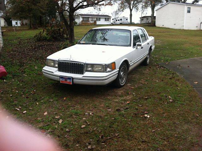

haha well this is crazy but I replace the fuse for the air suspension I saw it and it was smoldered into the fuse well I replaced it and it's back to normal 1993 TC 1.jpg1993 TC 2.jpg
Which fuse ? Smoldered? Fuse well? Congrats, that only took over a week to change a fuse.
