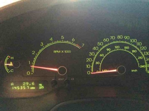

I do have a leak (oil pan). Checked oil. It's full. It came on a couple of times in the past. Stop signs, drive thru. Intermittent. Now it's constant. Anything below 1250 RPM will trip it. On a totally unrelated?? note, I installed an amp this weekend. The cold start problem was really bad this morning. Wouldn't be electrical problem maybe, causing low idle when cold? I didn't think it was going to get out of the driveway and down the lane this morning, but all at once it just took off.

Normal idle is about 750 RPM. You should have to go below 500 RPM to turn the oil light on.

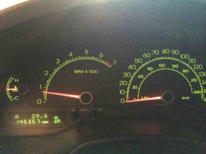

Unplugged battery to do some other work. Also located sensor and re-seated it. Hasn't came back on yet. Go figure. Runs like a champ other than when temp is
ImageUploadedByTapatalk1414449965.847524.jpgCar is possessed. :p

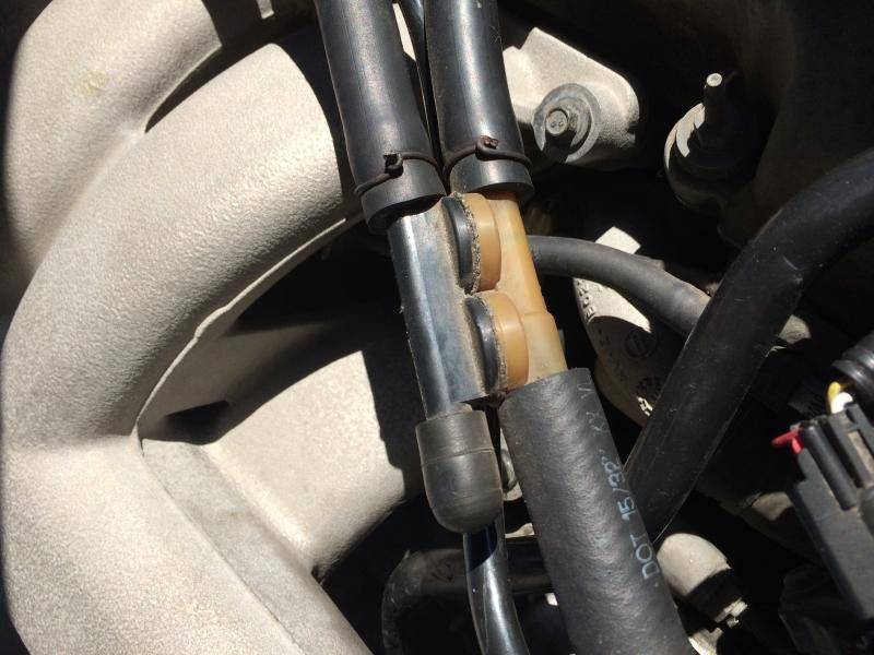

Also, I read somewhere that someone changed this part on theirs and it fixed it. Symptoms similar to mine. It appears to be some sort of valve. It is attached to the intake and the brake booster. Can anyone identify what this is called?

That's the "brake vacuum supply manifold." The part in the middle is some sort of valve. I think that it selects whichever vacuum is greater, the connection at the intake manifold or the connection at the throttle body. The manifold vacuum is higher at idle and cruising. The intake connection is higher at full (and near full) throttle. The assembly (valves and hoses) is 3W4Z-9C490-AJ. It's about $30.

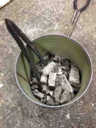

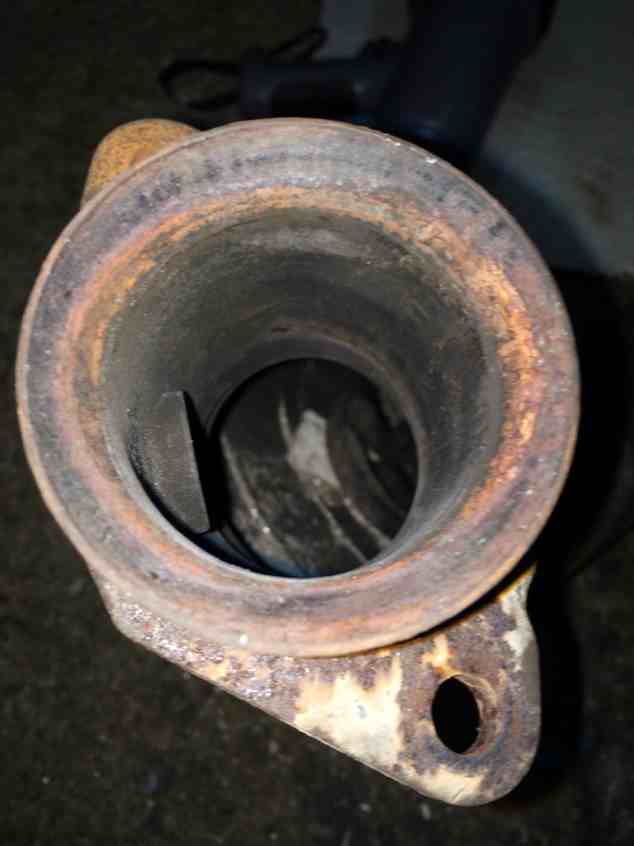

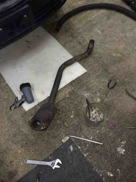

Cleaned this out. Still no exhaust pressure coming out of that side. Maybe the muffler or resonator is clogged. Geesh! Moral of the story. Don't let those misfires go long! ImageUploadedByTapatalk1415420349.703157.jpgImageUploadedByTapatalk1415420357.204715.jpgImageUploadedByTapatalk1415420364.670776.jpg
