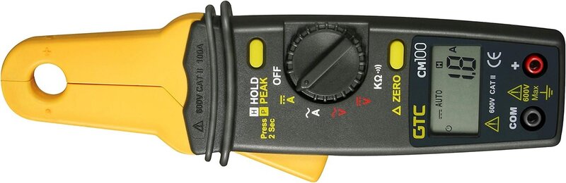

Can you post a picture of your meter and where you purchased it? I have never seen one that reads that small. Thanks in advance.
I looked for a while to find mine and now there are a number of them that can read that low. But the price has gone up quite a bit on the one I use? I paid around a $100 but maybe you could find a used meter too? They are on EBay.
GTC CM100. About $170 currently. I will say the ease of use and how quick I can go thru a car without disturbing ANY wiring is golden!
.001A DC Clamp On Meter
This may be a good one.
AMP Clamp/Multimeter | OTC Tools
My older Wavetec Meterman does it all, (including temp readings), and has the Amp clamp. I could also hook it up to a Windows laptop for multiple display readings.
