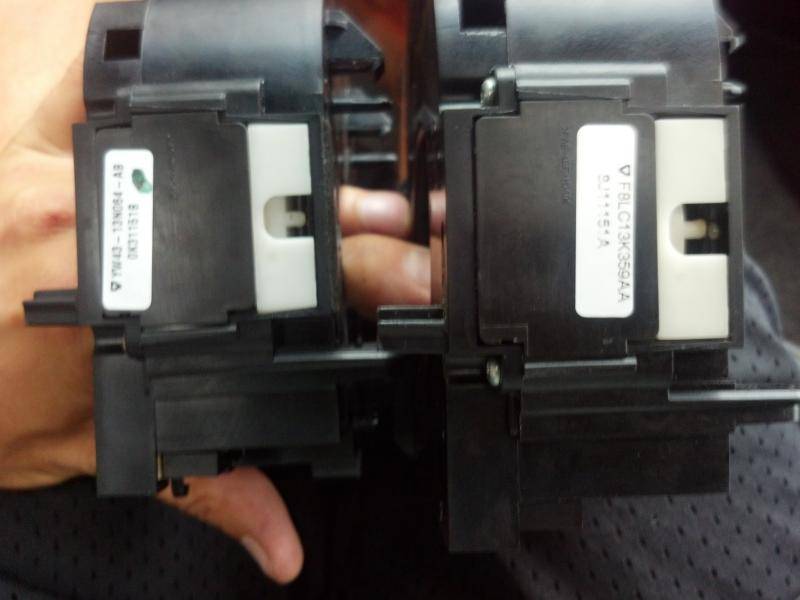

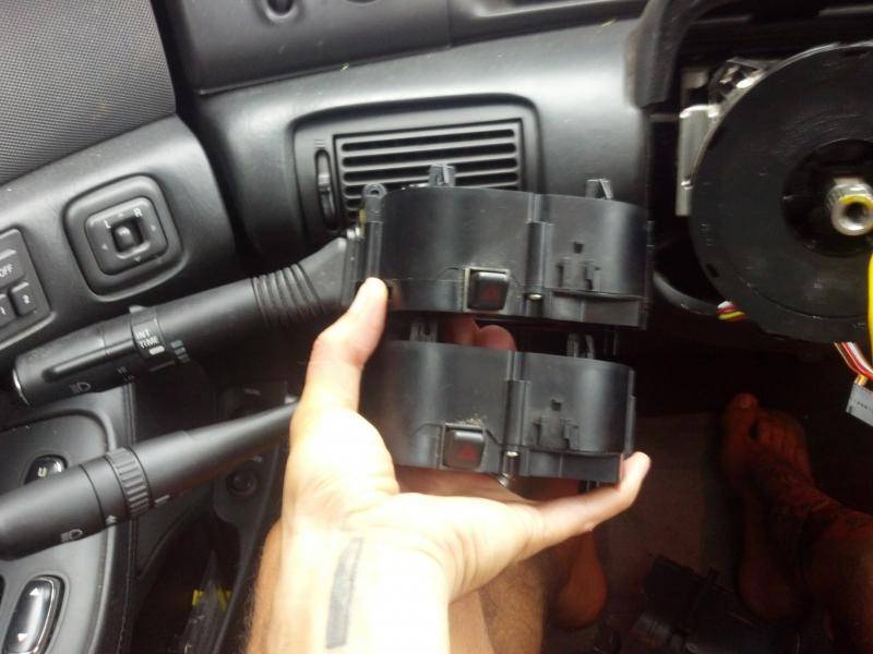

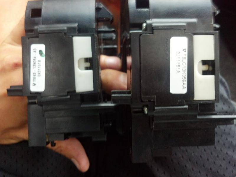

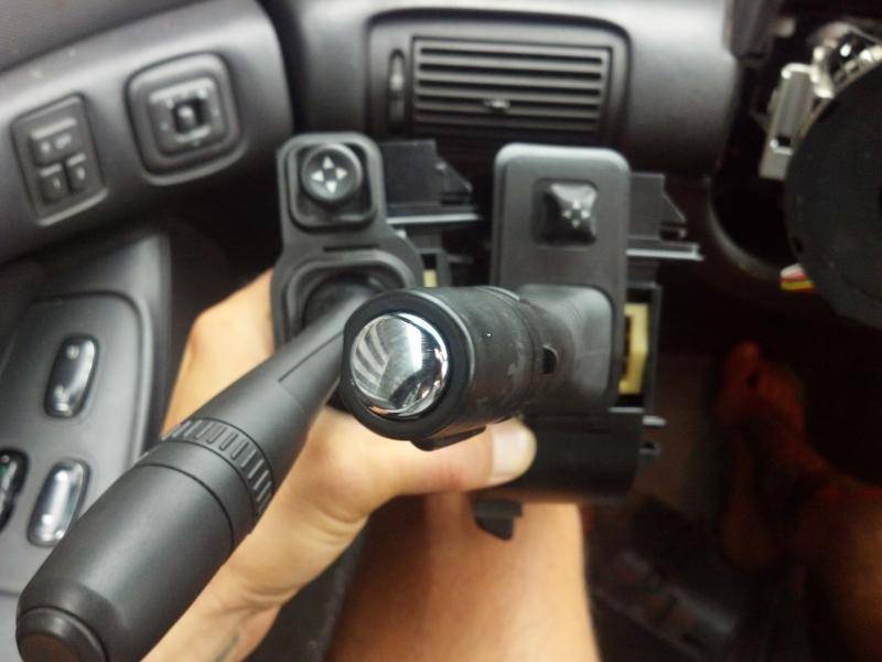

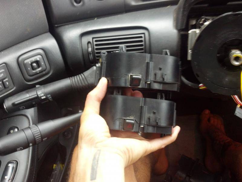

ok, heres the deal with the lincoln LS MFS..if you use one of these for your marks, there are 2 differences. ONE and the BIGGEST>>>!!! do NOT use the switch that has the Auto (moisture sensing) feature. The wiring is completely different inside. I successfully replaced mine with one that said Auto on it, and now the wipers do not turn off unless i pull the fuse. BIG PITA.. so dont do it..lol. Also, you will need to make sure the LS had memory seats, for some reason, this makes a difference on the MFS i have been told. second difference, where the lever meets the switch is a little different on the LS vs the MARK, so it wont look quite as finished when you put the column cover back on. i am taking the auto one off today, and believe the black cover that holds the lever and telescopic switch is inter changeable, so when i tear this apart again, ill let you know.
i am only saying this as if you are thinking about using the entire column, make sure your doner LS did not have the auto wiper feature, as its not compatible with our marks.
ok, here are some pics of the differences between the LS and Mark MFS... You'll notice they are pretty much exactly the same, and if i could get the wiring diagram for both the LS and MARK, I could probably get the auto MFS to work in the lsc..but i dont have either, and not going to worry about it unless someone really needs it and can provide the schematics for the flat plug that plugs into the MFS..
Also, I can now change out these switches, and the clock spring in under 15 minutes..lol IMG_20130801_084148_223.jpgIMG_20130801_084156_662.jpgIMG_20130801_084215_984.jpg
