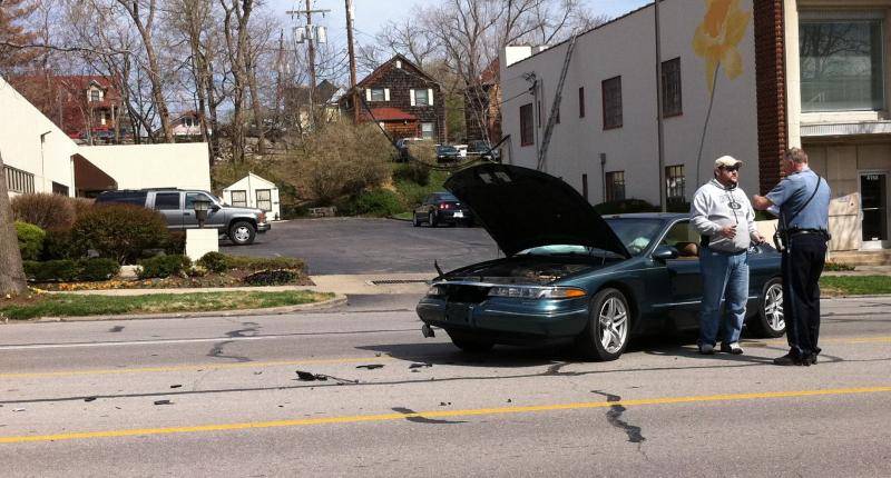

In my rearview It looked like something had happened, so I went around the block and came back. The horn was stuck on Mikes mark, and he was already out of the car. I was getting ready to get the horn unstuck when he said that we had to get the battery unhooked, as there was smoke starting to come out of the dash on the passenger side. People at the scene kept saying it was airbag smoke but this was a few minutes after the accident happened. Also, I know wire smoke when I smell it. So Mike and I stood on the front of the car and yanked the hood open and he cut the positive cable with my knife, and the smoke stopped. Hopefully the damage is minimal, but we'll have to get into the dash to find out. It was getting bad enough that I was looking for an extinguisher.

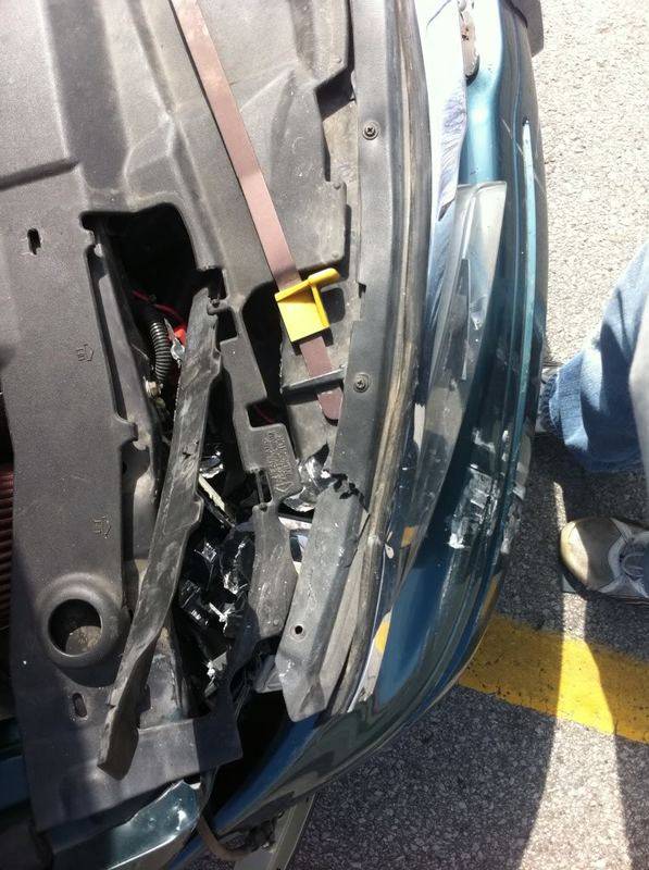

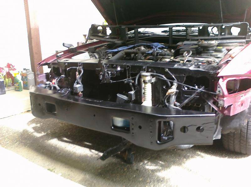

Body wise, the entire front end is trashed, and there is some body tweak. The inner apron area just in front of the strut tower is tweaked and has a bit of a kink to it and is shoved toward the driver side.
Only question I have, does anybody know is the front apron and structure assembly welded or bolted to the rest of the car?

Also, the inner structure is spot welded together. Chances are, if he can get it to a frame shop, they could tug it straight, then, worst case, put a core support in it. (Which I have one of on my parts car) Core supports on these cars are extremely easy.

By looking at this it looks like the core is Ok.
If core is ok, everything is a bolt on to fix it.

Well, Mike got the check for his car, and he bought his car back. I was going to rebuild the car for my daughter, but I sent pics to my friend that graduated Wyotech and he pointed out a few things. I will be stripping the car down to get parts for my Gen 1's, and I'll get some better pics, but bottom line is: Passenger Upper rail is bent down and over, passenger apron actually has a 90 degree fold in it, core support is shoved in and over, the bumper is shoved over sufficiently far that is had to do damage to the front frame where the bumper mounts. It appears to have actually shoved the driver Upper Rail over as well, but a frame machine would be in order anyways.
So all this adds up to, unfortunate as it is, the title says it: another Gen 1 bites the dust.
