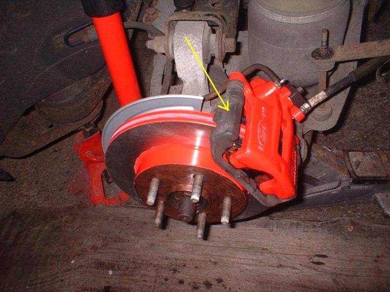

I'm begging........over here in the dark UK......with a worn slider pin on my passenger side rear brake:eek:
And to make matters worse, there are none in our breakers yards.
To top that off, its raining and cold:( And I've got worn slider pins:o
Can anyone take pity on me and offer to post one out to the UK please? Can pay immediately via paypal. Anyone got one lying around with no sideways play on those pins under the rubber protective sleeves?
And before anybody says, I know the photo shows the other side, but I'm pretty certain that they are the same side to side.
Anybody help me out? Please, please, please, ...............

No parts stores have them for a Taurus, Mustang, Explorer T-bird, Crown Vic.....?? They are all the same if memory serves. Shouldnt need a whole new bracket, just the pin kit.

I am referring to the pins only.
Also Marks have vented (fat) rotors and most other Fords have solid (skinny) rear rotors.

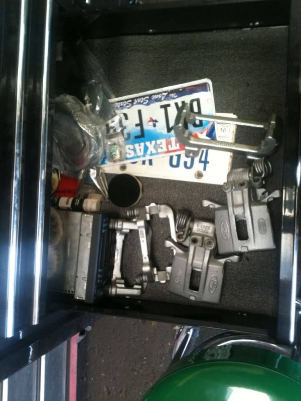

I've got the complete rear brake assemblys sitting in my tool box already, brackets and calipers.
I can send you just the brackets, if that's all you want
You can also fix those guide pins yourself if you've got a vise, some decent vise-grip pliers, some PB Blaster and a nice heat source
Soak it with PB, then heat up the housing around the pin with a torch, lock your vise-grips on the guide pin so you can try and spin it, it takes some effort tho. I've had to get those out of countless cars, Its a very common issue with Fords

Just FYI, the pins are too slack in the housings. Too much slack/sloppiness. We dont have PBlaster in the UK, but I have oxyacetylene:eek::eek:

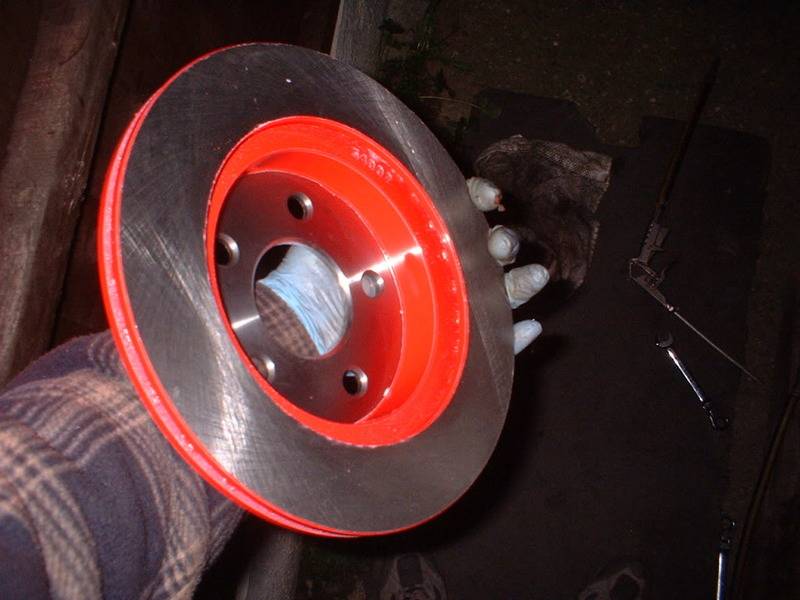

Rotors are brand spanking new (Rockauto) and powdercoated on the less important bits!

Did you paint where the pad rubs?
yeah. then got them hot and they cleaned off. then took it apart to remove all the stray flakes of paint. my rotors have zero rust. its awesome.
did it on mom's LS when we did the rear rotors on it a few months ago as well.
