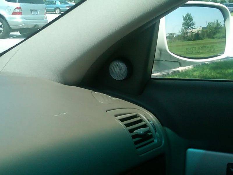

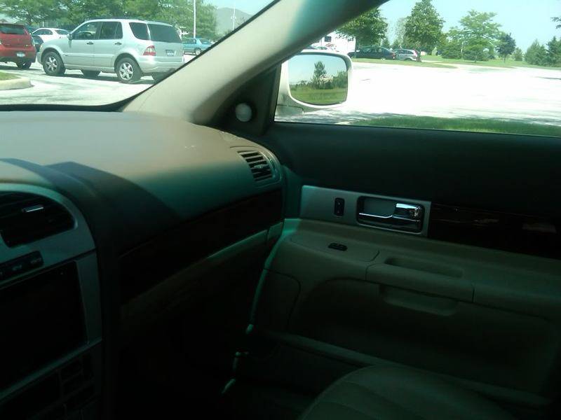

tru blu can we see pics of your tweeter mounted, I want to mount mine some where but want a nice factory look
I actually wish I would've mounted mine differently. If I were to do it again, I would put them near where the A pillar meets the headliner.
SSmith, here's a few shots (excuse the crappy BlackBerry quality) of the Kappa tweeter in the sail panel:

I was going to use the flush-mounts with the tweeters, but the space behind the sail panel was iffy, so I decided to go with what you see in the pic.

tru, i was thinking about put my tweeters there, have you ever thought about fiberglass or bondo around the tweeter
Nah, you'd have to be REALLY good to get fiberglass/resin to look somewhat of an OEM design - professional/competition skill level for sure. There would be a lot of challenges to deal with as well - designing the panels to be removable without damaging the shell, paint/color matching, etc.
All in all, I don't think it would be worth the hassle to go that far. While they don't look completely factory, I don't think my tweets look that bad, either. Like I posted earlier, I would have liked to do the flush mount route (it would have definitely looked more factory that way), but I didn't want to take the risk of ruining the sail panels if the housing cup was too deep and couldn't be used. I wouldn't have been able to do the surface mounts after that.
I still have the option of trying the flush mounts, but the initial measuring didn't look like it was in my favor. I decided that it would be better to get them mounted on the surface to make sure I liked what it did to the sound stage of the audio.
TRU
i would be careful putting the tweeters too close to your head, they will be pretty "bright" in that location and you really dont want to have too much distance between the tweeter and the woofer for proper imaging, also the closer one tweeter is to your head, the bigger the difference is in the distance between your ears and each tweeter is, and then you make time alignment issues worse (some radios do have time correction but its very uncommon) and you really dont want the same sound leaving both tweeters at the exact same time, and arriving at your ears at different times (because the sound from one tweeter has more that twice the distance to travel) for the best imaging, you really want the tweeters to be as close as possible to the same distance away from your ears (which usually means putting them as far away as possible to minimize the difference in distance: like at the base of the a pillar or in the panel closest to the wind shield )
ive worked on a couple of cars that have had tweets mounted real high and it was just too much, kinda gave you a headache.
I was thinking about aiming them more towards the glass.
I was talking about it with one of my customers. He was an engineer, and was on one of the teams that originally developed the JBL/Infinity systems in cars. He actually made the suggestion that he would've placed them higher, and aimed slightly towards the glass. We didn't get into too much detail about it.
thats how a lot of the newer GM's and Nissan's with bose have them, but not too high, about 1/4 of the way up the a pillar.
i did place mine in the panel that has the PATS light and the defrosters pointing up toward the glass, and it does sound great.
