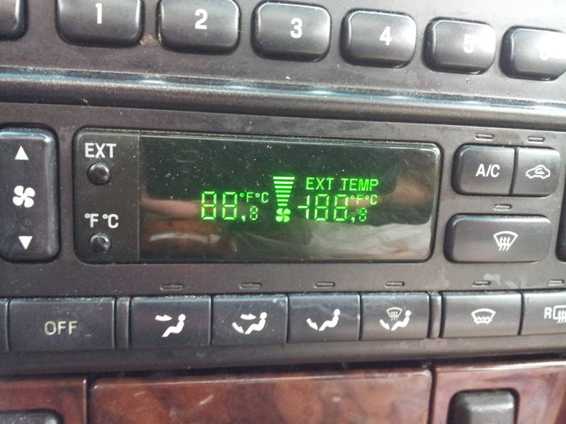

In other news, I did the self test to see if my DCCV or whatever it's called is working correctly. This is my result:
Good or no good?

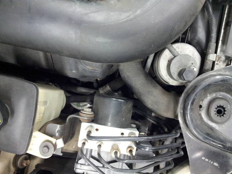

Is the aux pump somewhere in this pic or is it hidden below that stuff?

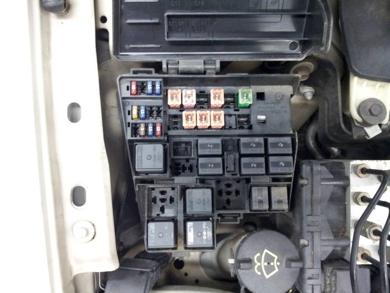

Am I missing some important relays? Obviously there are blank spaces but I mean am I missing ones that need to be there and if so, what are they?

...Am I missing some? Obviously there are blank spaces but I mean am I missing ones that need to be there and if so, what are they?
Am I missing something? We've jumped from a heating problem to looking at the ABS? No, you're not missing any brake line connections. If you were, you wouldn't have any brakes.
You can get a PDF of your owner's manual from the tech articles section. Looking at pages 177 and 178, your underhood distribution box is not populated the same way as the manual indicates. I wouldn't go switching things around though. Maybe the documentation is wrong.
Sorry about the confusion. The picture must have been cut off. I'm don't everything from my phone, hence the random words provided by Swype.
The picture you referenced was asking about the aux pump. If it's in that picture or somewhere deep inside. The right side of the picture is the passenger side of the radiator.
The aux pump and the DCCV are hidden below the AC receiver/dryer in the picture. There's no way to see it from that picture.
