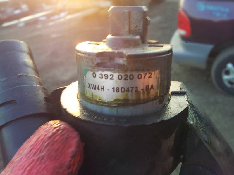

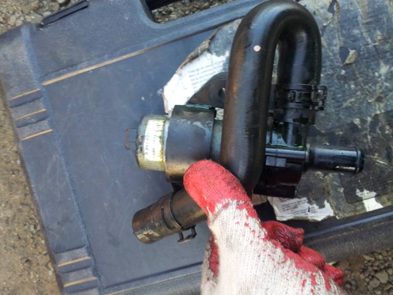

Do you not have an 01 V8 ?
... a different P/N ?
odd.
EDIT: thanks for the pic btw.
I noticed that you did not mention the thermostat as a likely culprit for no circulation so does that mean I don't really need to worry about changing it?
If your thermostat was not opening allowing coolant to flow through the motor, then your car would be overheating.
odd.
I do have an 01 v8. This came out of a salvage 2000 v8. I didn't see anything on the body of the part, only on the sticker.

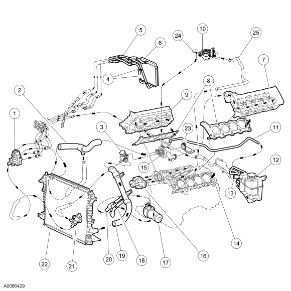

The auxiliary coolant pump:
- provides heater coolant flow boost.
- has a secondary function of providing engine-off cooling.
The auxiliary coolant flow pump is electrically driven and provides increased coolant flow during low engine speed operation. The pump is also used to circulate coolant after the engine is turned off under certain conditions.
If the auxiliary coolant pump is inoperative, you will notice reduced heater performance at low speeds and at idle.
If too little coolant is circulated, the blower fan will pull enough heat out of the coolant and cause the heater core to get cold. (quicker)
In addition to providing assisted coolant flow for interior cabin heat at low RPM, this "dumb thing" also continues to assist with coolant flow cool-down after you walk away from it.
The only "dumb thing" here would be to bypass, remove or not replace it, you'll need it come winter!
Coolant Flow // Item #21 - Auxiliary coolant pump
The auxiliary coolant pump is declared faulty/defective/not working, when there is sufficient interior heat during higher RPM's but no heat during idle RPM's. In other words, when there is no heat from the vents during idle but lots of heat during driving speeds, it's time to replace the 12V BOSCH coolant pump.

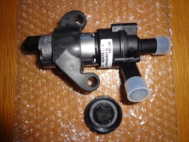

Re&Re - OEM Auxiliary Coolant Flow Pump - GEN 1 V8
