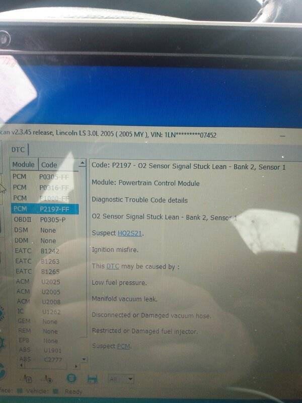

Found out yesterday one of my upstream o2 sensors is failing, changing both today though.. hopefully it solves everything
Hopefully you bought NTK ... and not Bosch.
Motorcraft. Changing the 2 upstream sensors seems to have fixed the rough idle
But now it's back to giving the good old p0420 code. fun times!
Bank 1 sensor2 is reading between 0.06v- 0.11v with intermittent spikes going up to 0.65 (maybe this sensor is failing?) and bank 2 sensor2 is reading 0.04v - 0.07v with no spikes.
Bank 1 and Bank 2 Catalyst temps are the same currently at 866°F..
Hooley Moses! That's a lot of codes! You sure your battery is happy?
Most of those are related. I would guess just one root cause for the engine codes. He can probably ignore the two AC codes.
