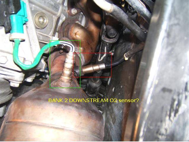

BANK 2 driverside downstream O2 sensor bad.
It's just past the catalytic converter on the drivers sides exhaust. Get under the car and you cannot miss it. It is very easy to replace.
is the bank 2 downstream red or green?
nope that's the upstream one, there's another one on the other side of the cat.
My picture is confusing - since I have a wideband O2 sensor for tuning - so I have three on the one side, two upstream...
ok so i jacked up the car, and observed haha, is the bank 2 downstream the one on like the pipe between "past the cat" and the resonator?
Spray it good with PB Blaster (not wd-40) and take it out while the pipes are hot. This will help
