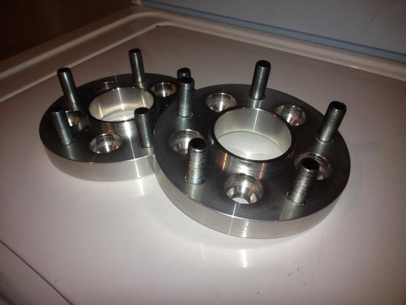

Here's a pic of 2 of the adapters.
I have been looking at the same tires. Definitely want the 40 series tire for a smoother ride.
If I can ask how much did you get the adapters for? I know they aren't all that cheap but are a great quality from what I hear.
If the 40 will fit without rubbing then I'm for sure going with it as well. The YK580 is most likely the tires I will buy.
It was $260 for four adapters, $20 for twenty lugs for the adapters, and another $20 for lugs for the wheels. Also, $25 for shipping. So I paid $325 shipped.
You don't have to buy the lugs from them, but I would suggest it so they are guaranteed to fit properly.

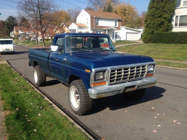

Well after I get my tires the LS project might be on hold for a bit because I'm thinking of buying an F150 for winter driving. Keep the LS out of the salt.
haha those are sweet man. I would love to restore one some day. don't know much about them but did they come in 4x4?
by the way, what is the ETA on the tires? Not pressuring you lol i'm just wondering bc i may need a favor :D
Yes sir, this guy is a 4 wheel drive.
Not really sure yet about the tires. Kinda depends on this truck lol
If I do buy the truck it'll probably be a couple months, but if the truck is a no go then the tires will be ordered within the month I think.
