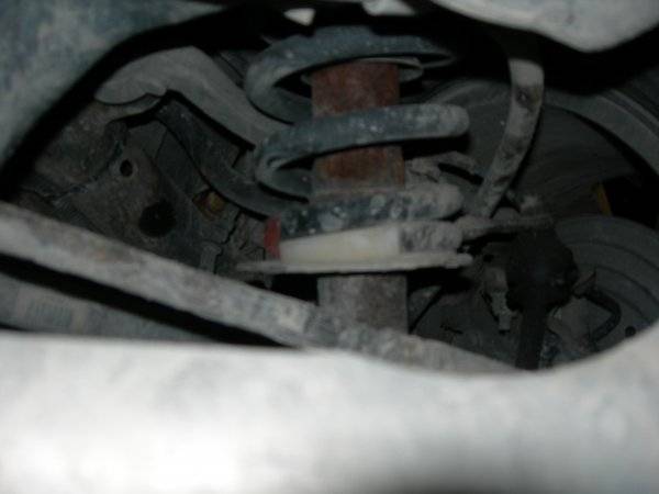

BCA,,, if you can find a part # on the bottom spring seats,,, that would give the last answer to all of the Jag parts needed for the rear setup on an LS.
I looked under there this weekend and found no visible numbers on the bottom seats that were visible.

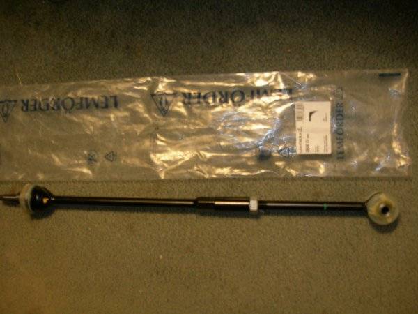

From the searching I have done on the Jag forum... no one has complained about a soft ride on the S-Type with B4 Bilsteins. However,,, those wanting a stiffer ride do seem to go to the B6 version. I know what my LS felt like when it had 100k less miles on it. Granted,,, I'm only doing the rears for now, (and other suspension parts)... but hopefully I have it done by this weekend and I can report back. I also recently purchased some lateral toe links for the rear that will be installed at the same time as the LCA's, shocks, and springs.

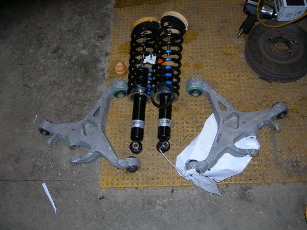

With the new format of the site,,, I can now post pics.
So... here are the, (still uninstalled) rear suspension components. I will also include a pick of the rear bottom spring isolator... that is unobtanium since the OEM shocks are mostly NLA.
