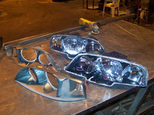

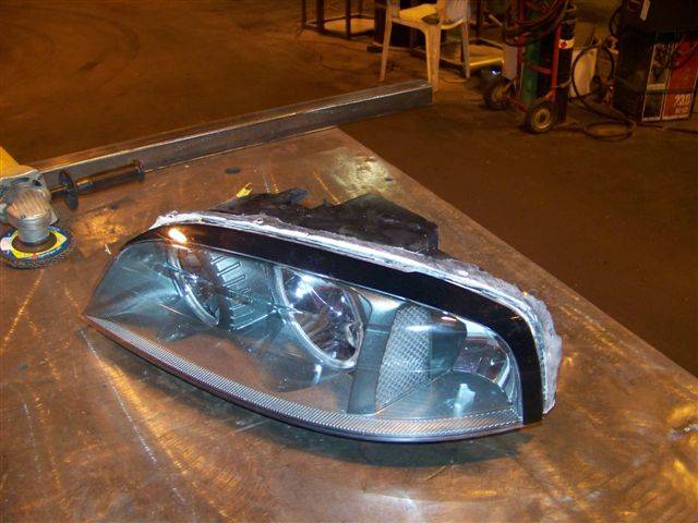

I used a 1/8 inch cutoff wheel on a small electric grinder as in pic.
It's quick and makes a nice cut but just be careful not to cut into the bezel when you cut it across the top.
Since you have it apart color paint the bezels.

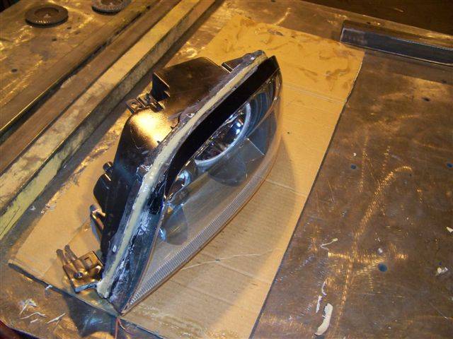

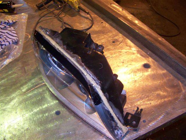

Use a hot glue gun to spot weld it back together then use PL Premium polyurethane adhesive in a cartridge tube available in the paint section at any Home Depot.
Run a nice bead and use soapy water to smooth it.
Let cure overnight, brushpaint seam black and contact cement the rubber back on.
