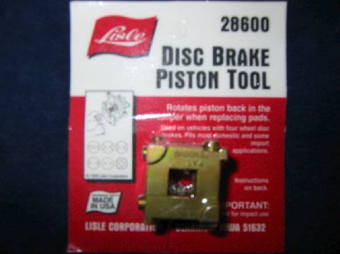

instead of pushing the pistons back in you need to buy a $10 tool to turn them in.
Here's the tool I purchased....
