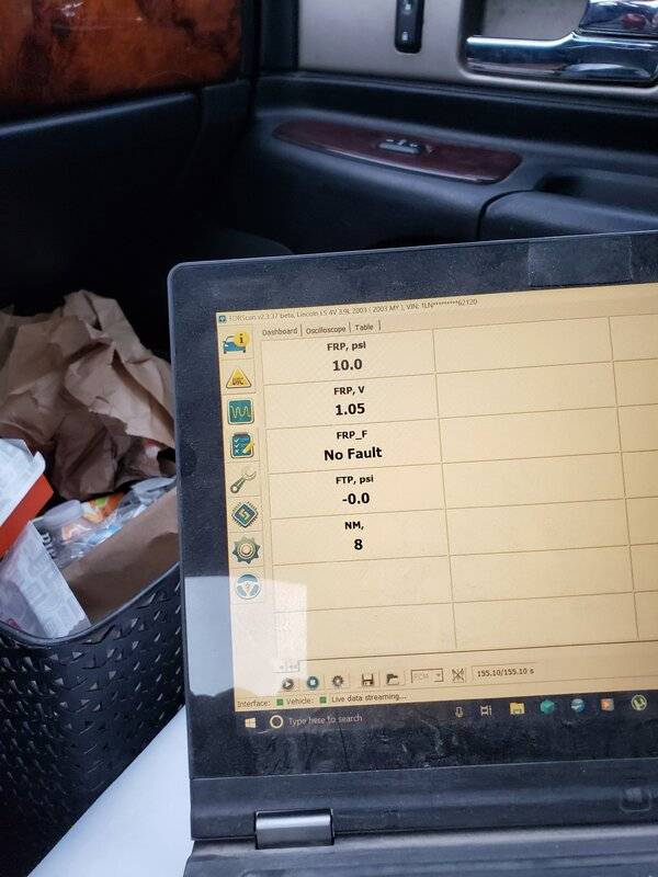

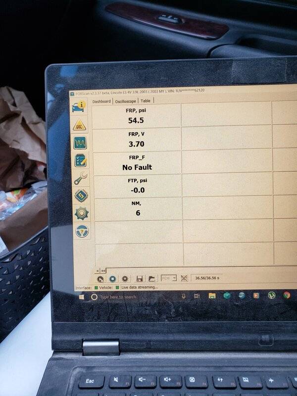

Here's at idle before I find the graph page,

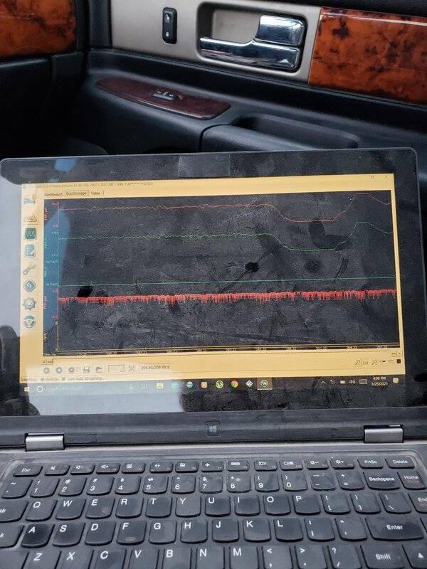

This was WOT accelerating, guess it went down to 10.
Seems like you have a fuel delivery problem. I wonder what fuel pump the last guy put in? Not Airtex, I hope.

Not sure, think he said it came from eBay. I'll continue with my filter change then and see if that helps. Not worried about the 6-8 misfires? Thanks

There should be no misfires, but low fuel pressure can cause misfires. Correct the problems that are clearly identified before looking for other issues.
Code p0191 showed up now also,
The dip is where was accelerating, it definitely went lower pressure than yours, I saw down to 17 or so, it didn't run or shift correctly on this run, when I accelerated to the floor and the RPMS went up but it never did shift, kind of didn't have enough power and just kept the RPMs higher but wouldn't shift right, only a short run though, it shifts if I give less throttle.
What are your readings for shift solenoids ...any faults showing for this PID? You said it's not shifting gears correctly? I might be totally taking this the wrong way...explain what you mean it's not shifting correctly? I suppose if your having misfires this could cause it to shutter/stutter...
Yeah just kind of stuttering, like if I give it less throttle it shifts fine, I'll have to do more research on that forscan and figure out which things I want on my list of whatever to look at live data, thanks.
