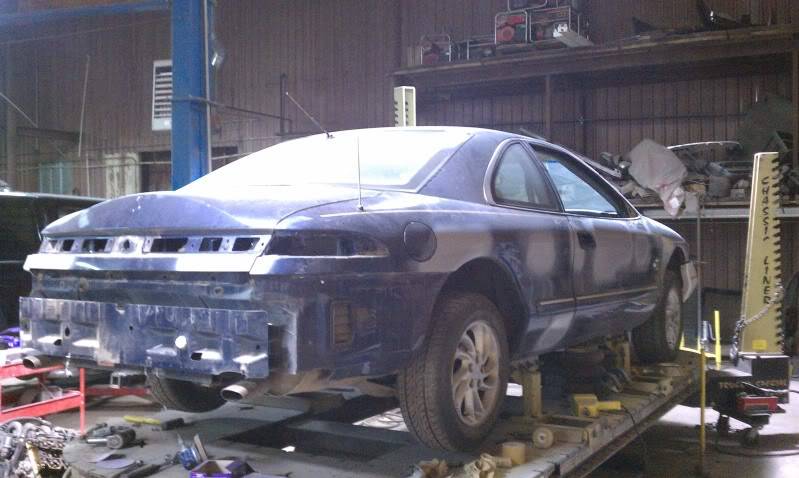

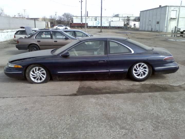

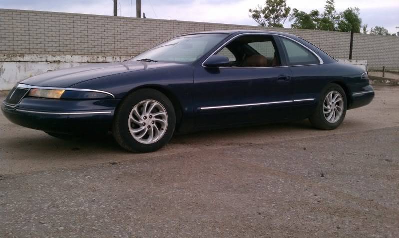

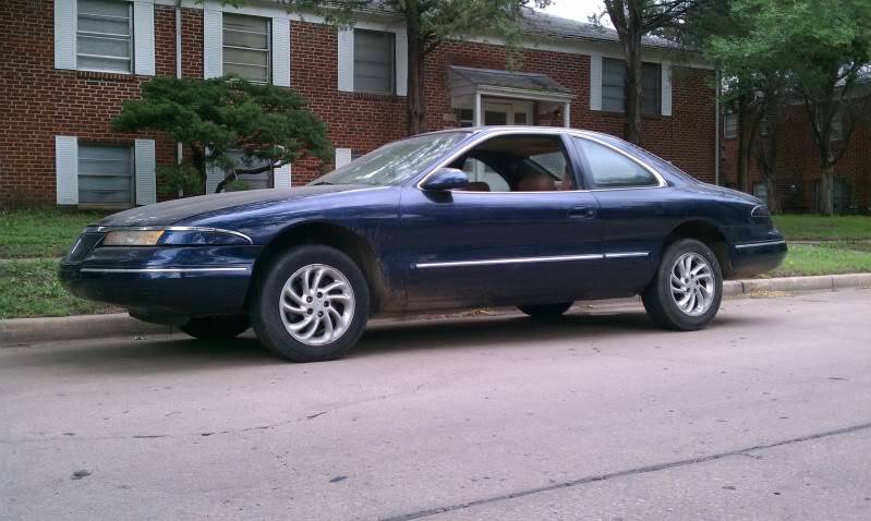

how i bought the car

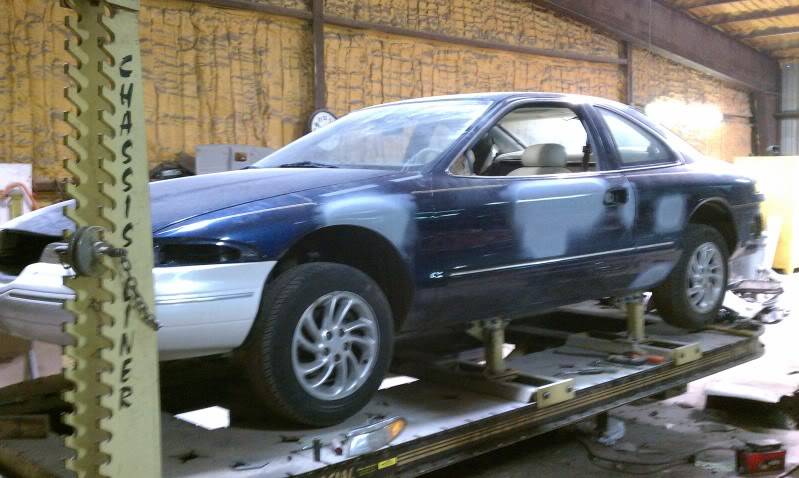

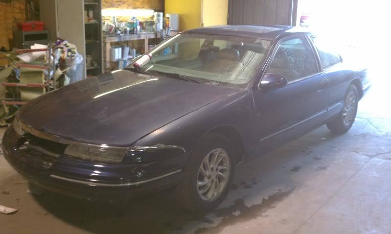

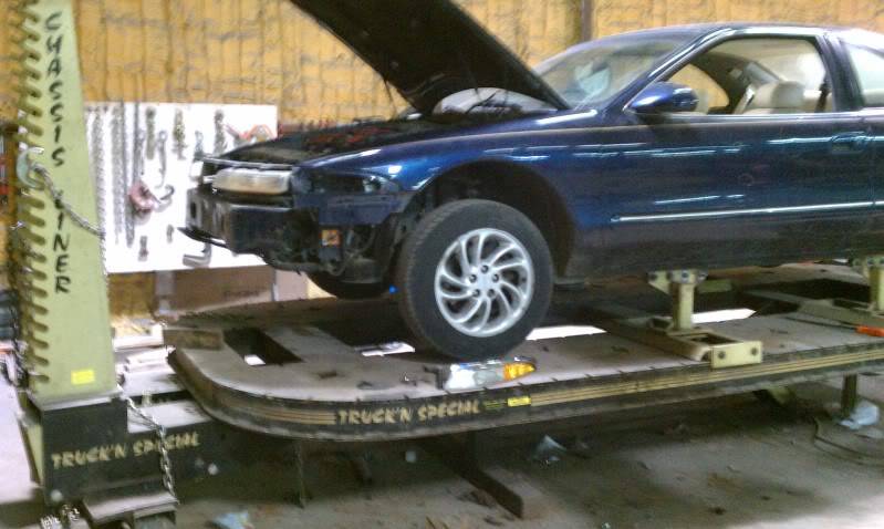

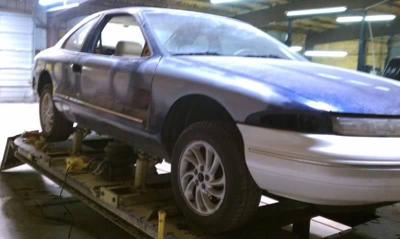

radiator support was over to the left about an inch so i put it on the frame rack and pulled it straight
fixed all the door dings and other dents on the car

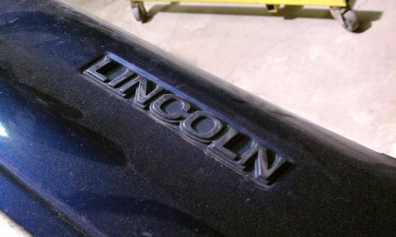

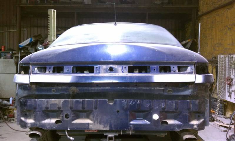

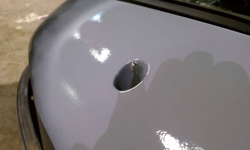

shaved the hole for the emblems

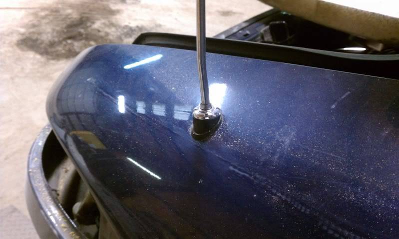

antenna before
frenched

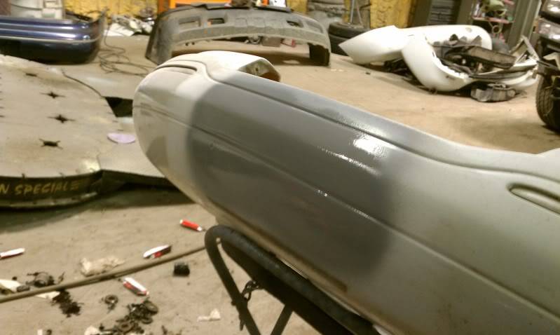

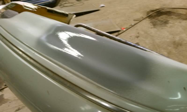

bumper emblem before
and shaved along with a diffrent undamaged bumper

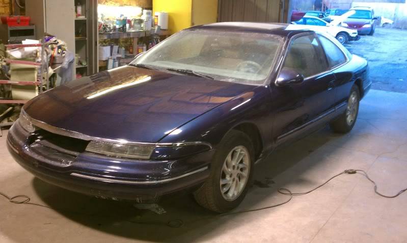

in everything you see (or will see) i have 1800 in it but thats also no labor since i did everything
also shaved tag bracket holes

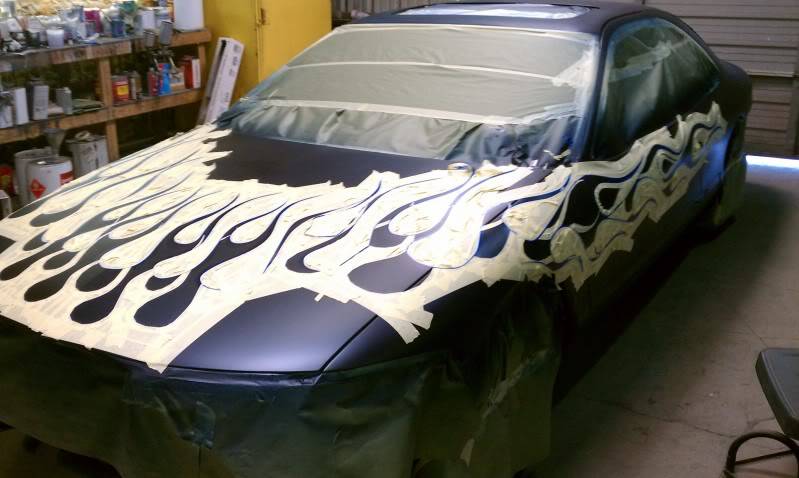

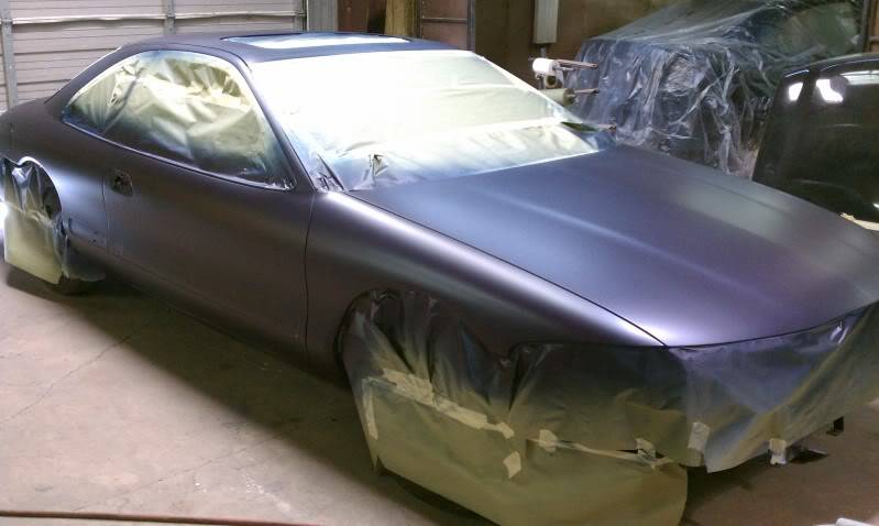

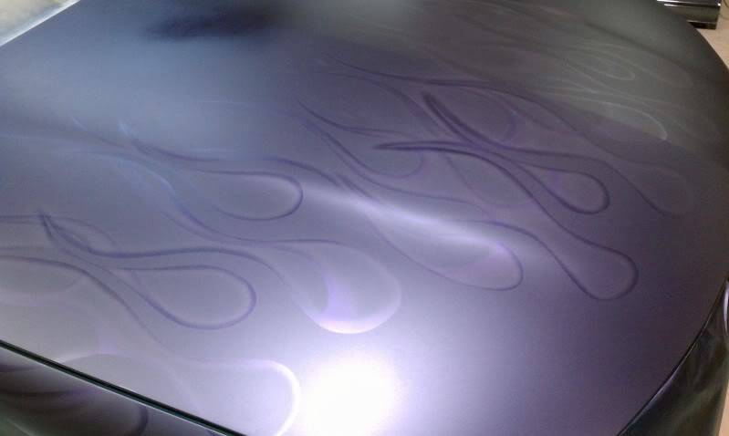

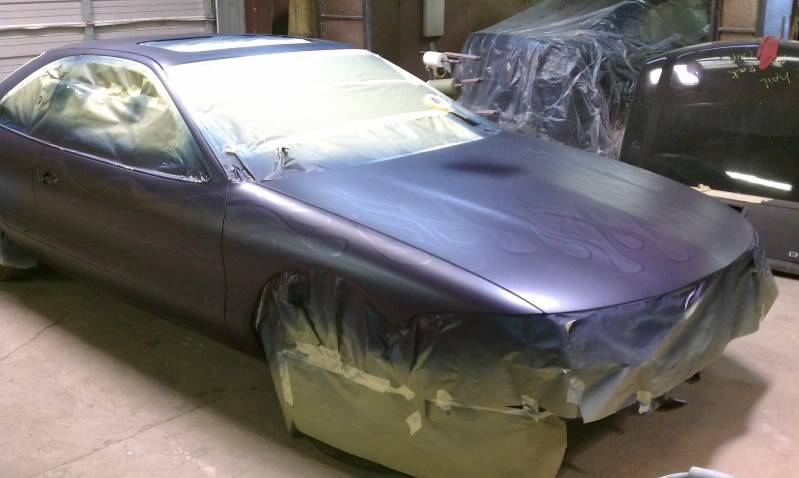

car masked and based the blue is the factory blue but i added some house of kolor violet dry pearl to it to give it a nice burple color so in some light its blue and others you would swear it was purple

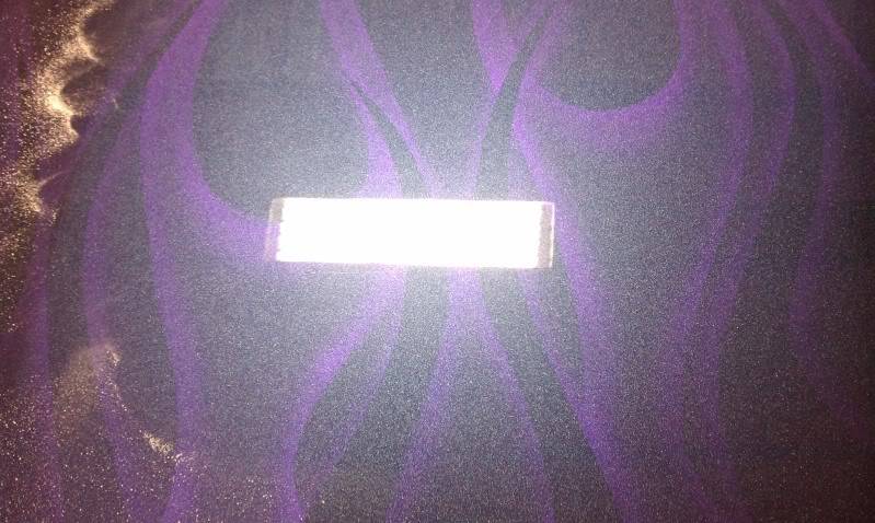

flames all masked

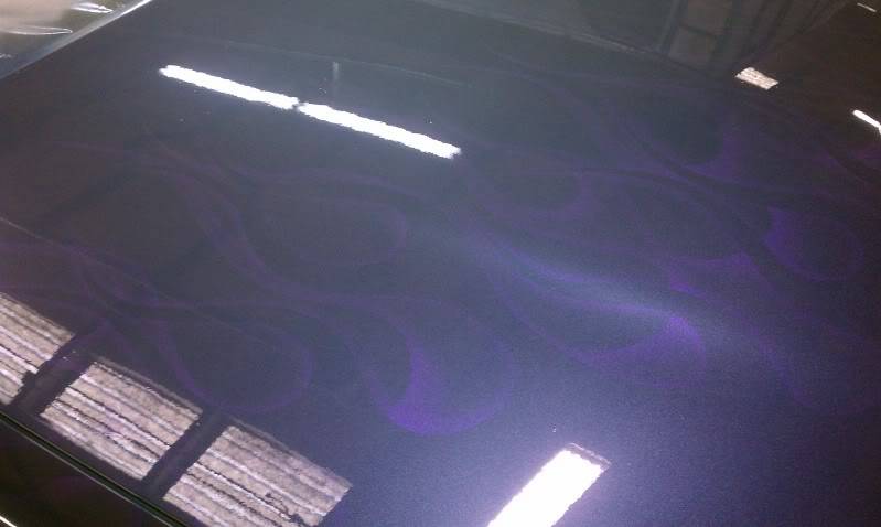

flamed and unmasked
little close up

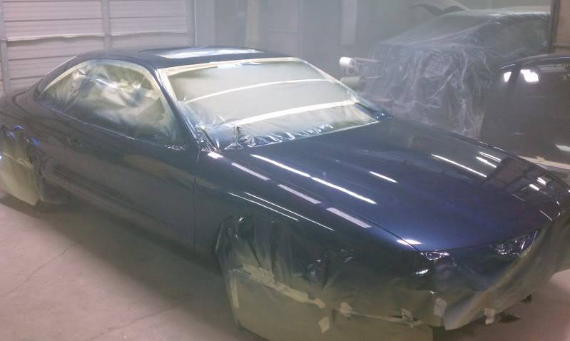

cleared
nice and smooth

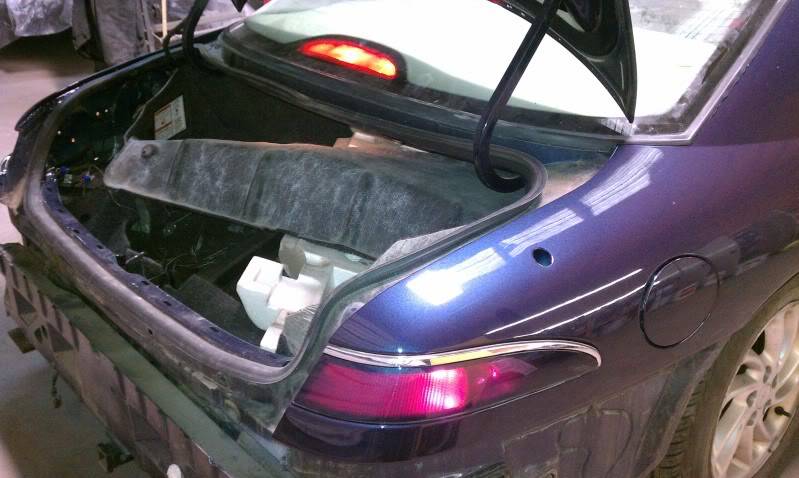

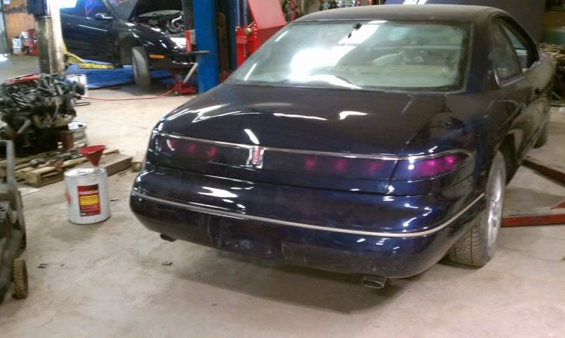

tails before
kandied

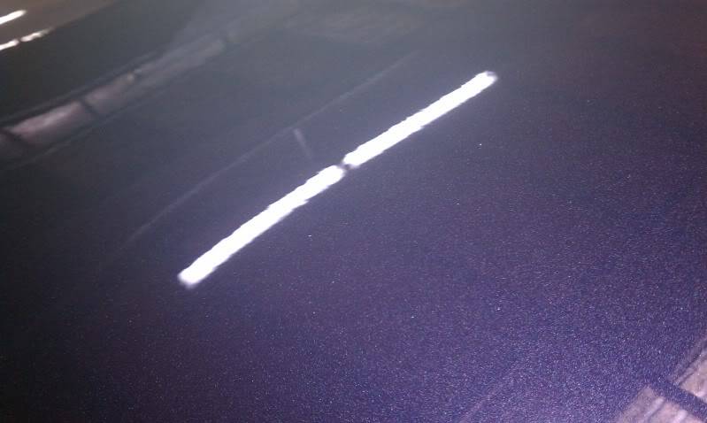

wet sanded
polished out
another close up

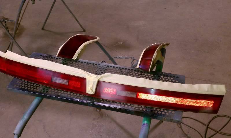

tail lights on
brake lights on

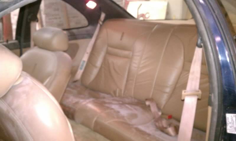

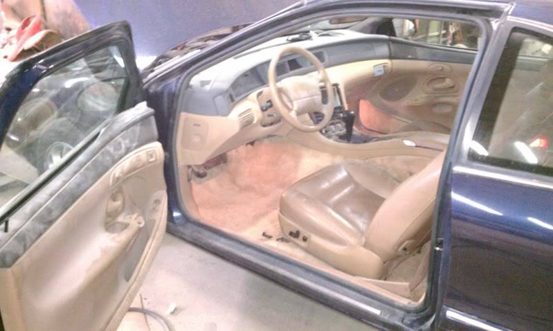

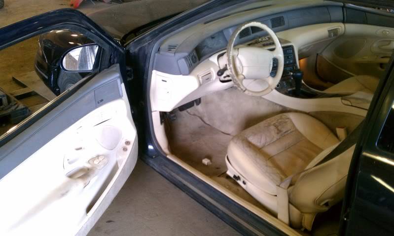

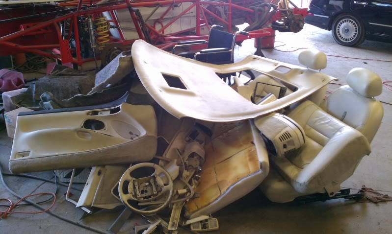

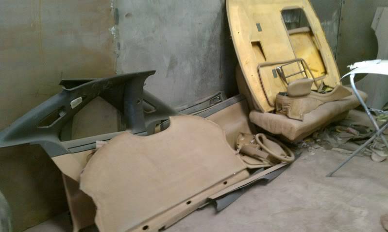

old ratty white interior
new peanute butter interior and yes the name of this car is "peanute butter jelly time"
installed
all the old ready for the trash

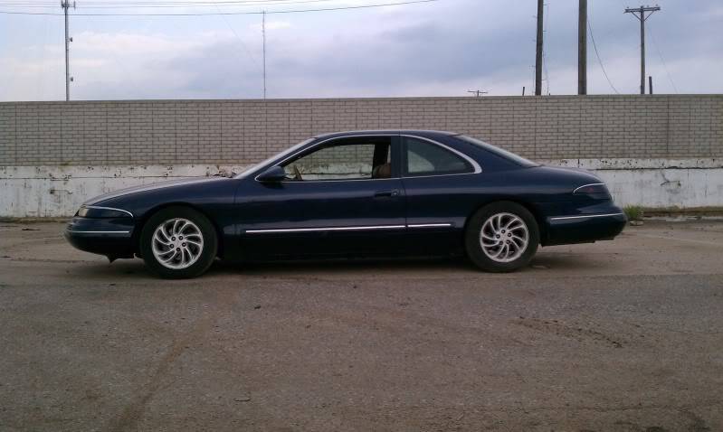

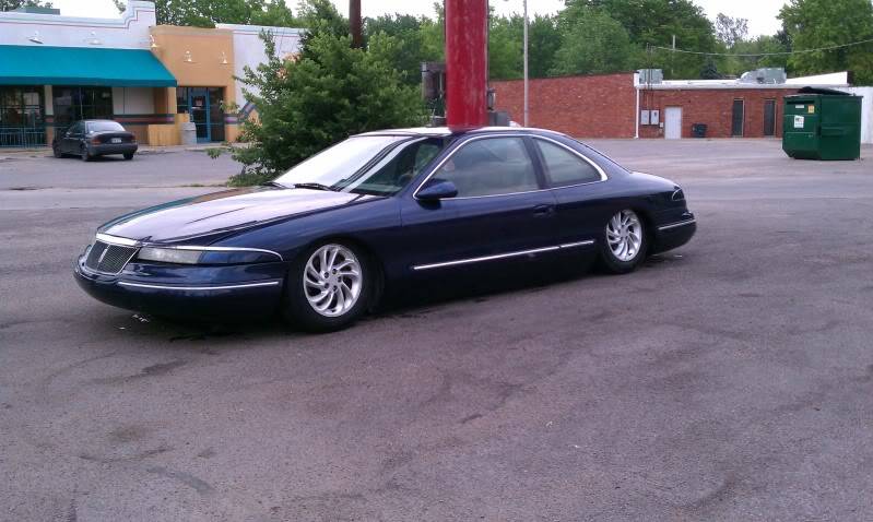

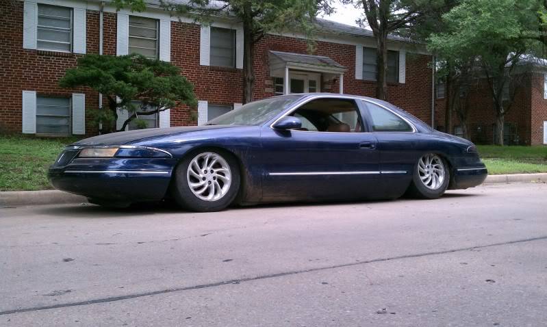

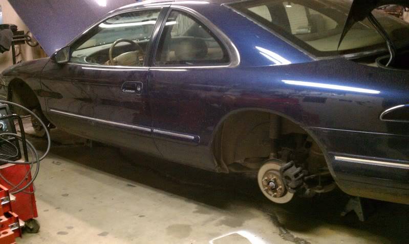

decided to lower it some for no reason really because i never drove it while it was lowerd

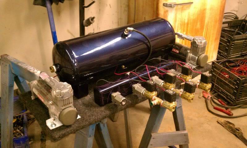

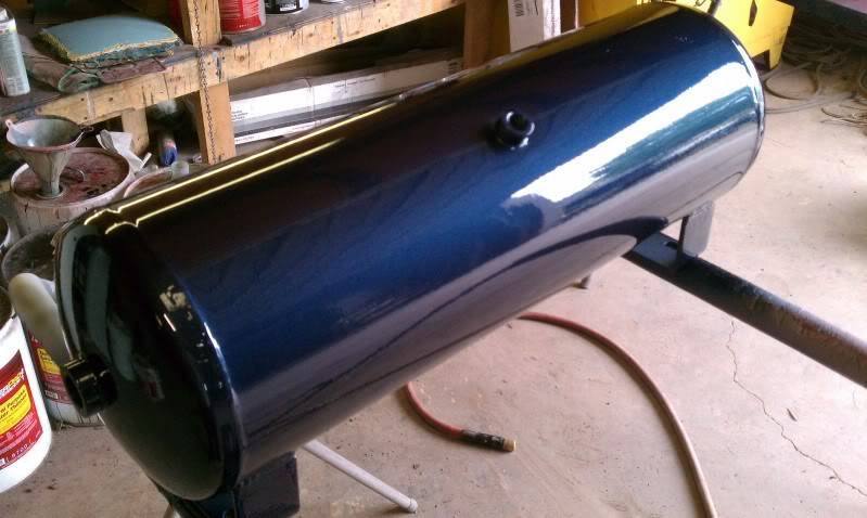

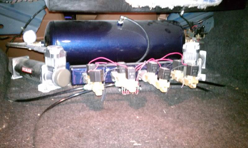

color matched 5 gallon air tank
color matched valve distribution block with some purple striping
all assemebled minus 2 valves
ready to be bagged

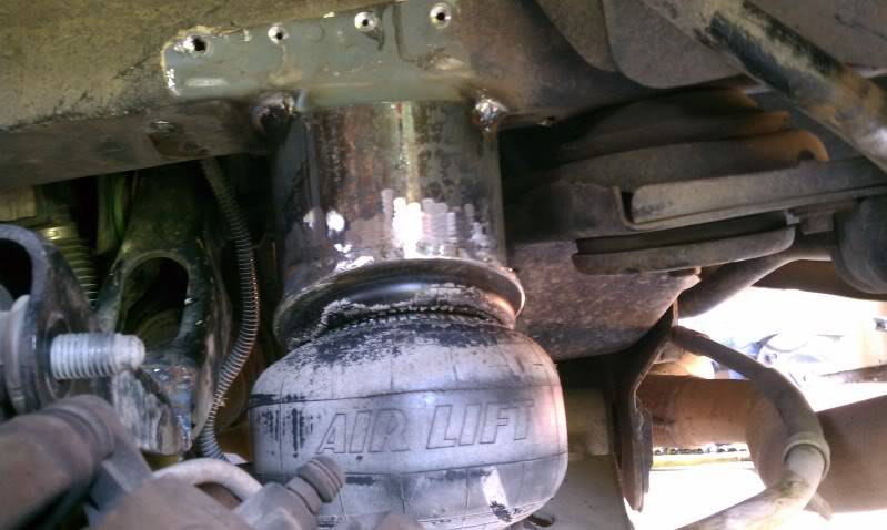

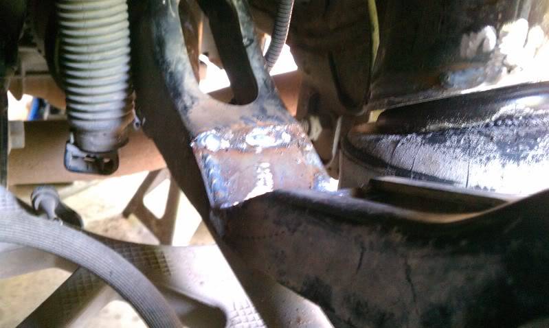

notched the upper arm i dont have a pic but i added some gussets to it to bring the strength back in to it

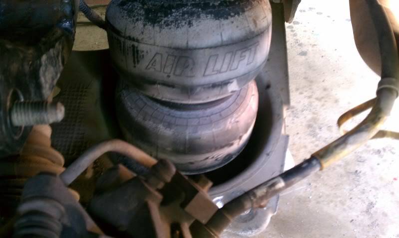

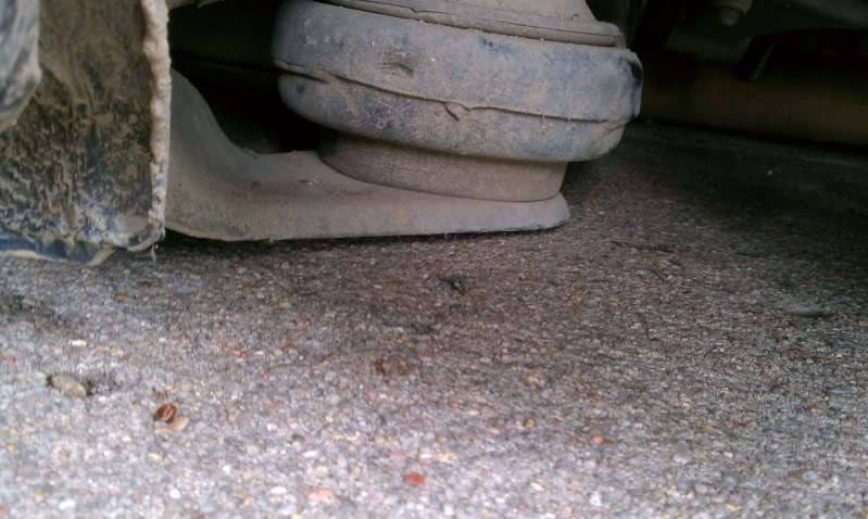

i dont have pics but on the front i used the factory strut bag but modified it to let the car actually lay out flat unlike they would stock

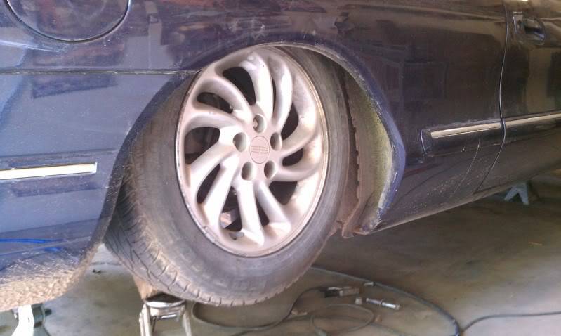

the car layed out flat
locked up

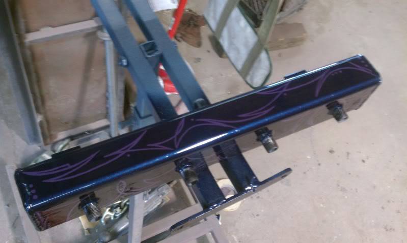

no pics but i later plated this mount because it would drag the craddle bolts and i dont really want to drag threw them

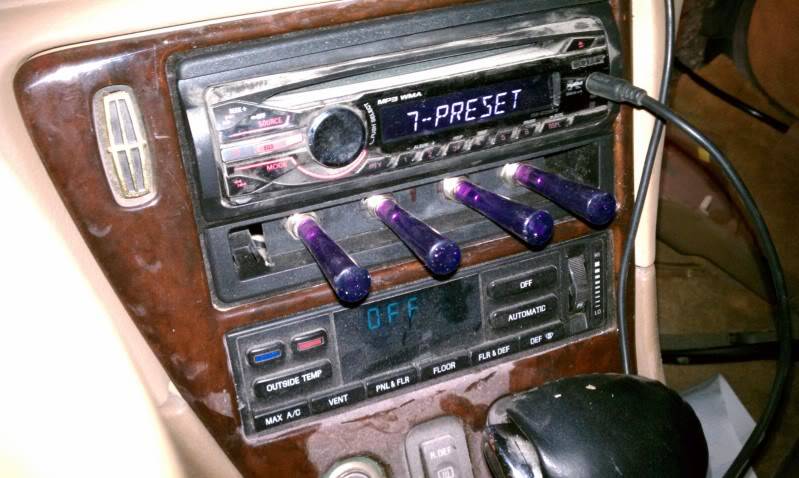

switches installed with matching purple exstensions

Wow. Tire companies are gonna love you. I assume the sway bars are eliminated now? Thats a serious drop. Is the car now gonna be a show car or is it actually gonna get driven?
only time it wears the tires are when im smoking them:D and no it still has both sway bars and i drive it every day. it atcually just got hailed on about 45 minutes ago but it was pea size so hopefully no dents

So how did you do the front? Did you just use the stock bag/shock or make a new mount for the fastbag setup?
BTW, that much negative camber will wear tires uber fast on these cars. I had camber at -1* and managed to waste a new pair of expensive tires on the inner edge in under 3000 miles. To -.2* as possible.
the camber dont actually kill tires its the toe when lowerd or layed out it does toe in some but raise it up to drive and your golden. and on the front i wired the factory valve to work with the switch, used a union to go from the factory 5/16 line to a 3/8 line and modified the lower strut mount to sit an inch lower on the arm
