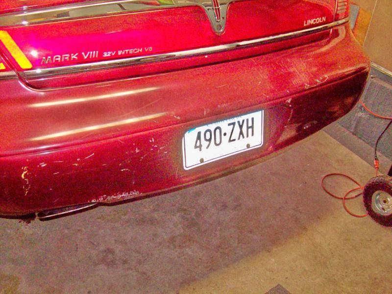

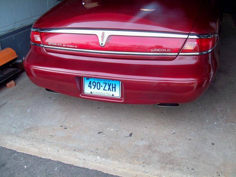

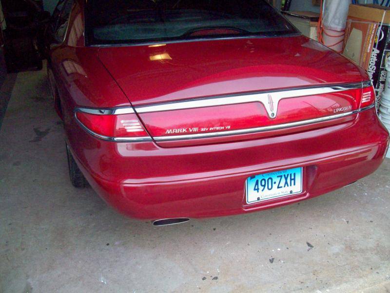

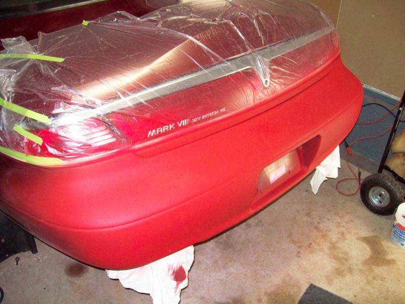

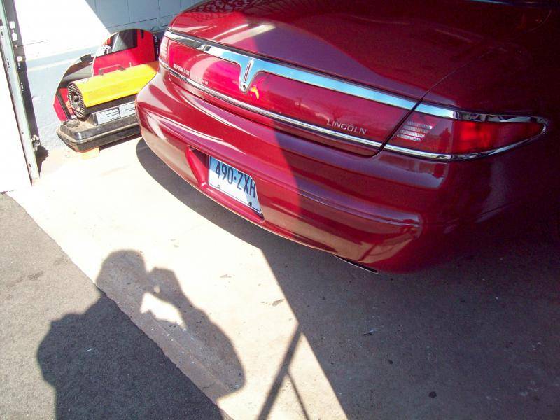

The rear bumper on my 97 that I just got needed some work. The spray cans from Automotive touchup are some of the best I've ever used. You need sunglasses to look at the red primer. 97 BUM BFR.jpg97 BUM PRI.jpg97 end.jpg97 end 2.jpg97 BUM FIN 2.jpg

YES They got it You have to send them your paint code I think it's 2 paints you have to use for the pearl white.
WOW! Let me get this right; you're saying you did that with spray cans?
The rear bumper on my 97 that I just got needed some work. The spray cans from Automotive touchup are some of the best I've ever used. You need sunglasses to look at the red primer.View attachment 828458422View attachment 828458423View attachment 828458424View attachment 828458425View attachment 828458426
He is the KING of RATTLE CANS !!
If this job was truly done on rattle cans then I no longer wear the crown. I sir thou hand over my crown as former King of Spray & now pronounce you the new King of spray! Hip, hip hooray!

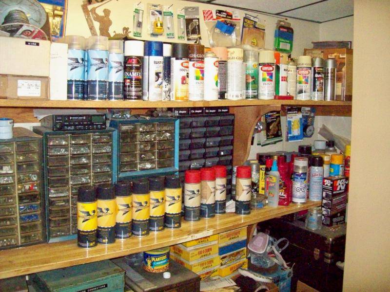

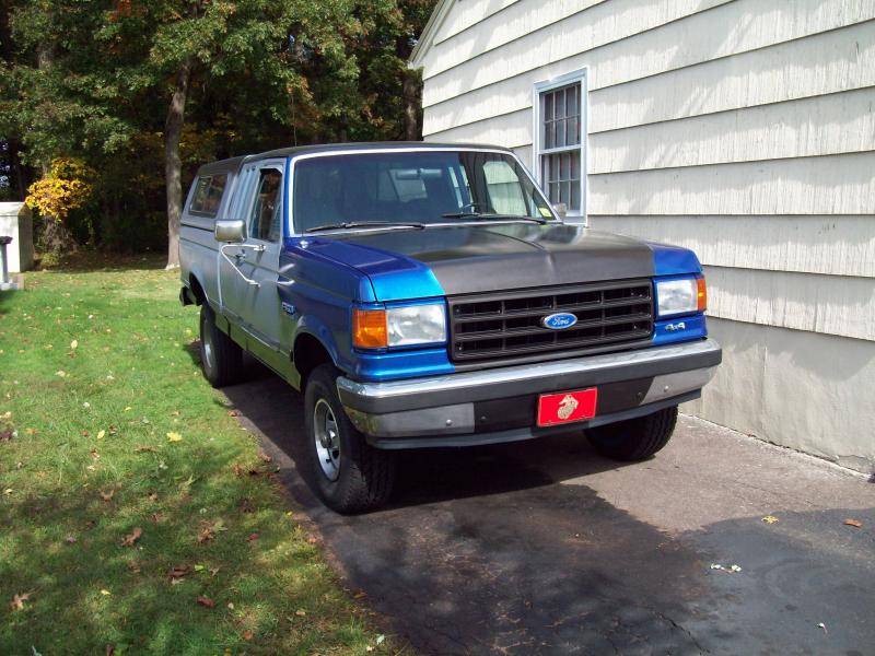

100_0851SPRAY PAINT.jpgTRK 2 TONE 2.jpgThank You, I'm touched to get that honor Yes it was done with cans. I've been practicing for over 40 years. Pic of spray cans downstairs, have more in the garage. Pic 2 my old PU that I never finished,done with Rust-oleum from home depot,Cobalt blue metallic and hammertone black. This automotive touchup is the best I've ever used, it's worth the money. OLE Bruce (dbleb88), just did some white(2 paints) and is shocked how good it worked. Where do I get my crown, burger king? Thanks for your kind words TONYyyy

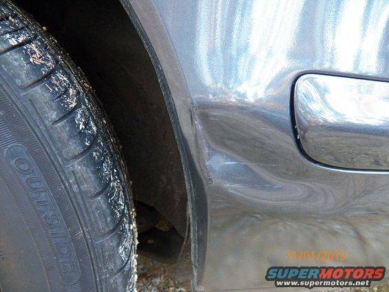

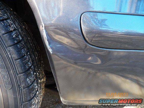

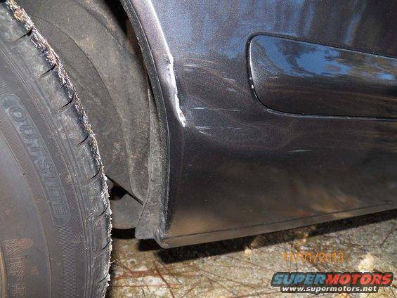

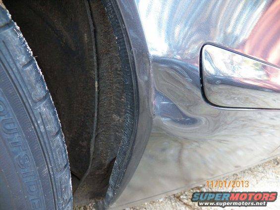

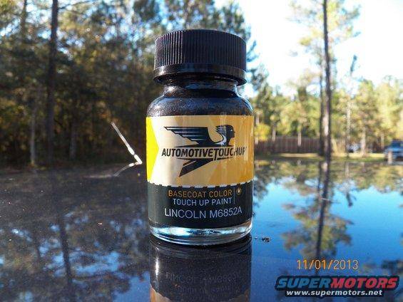

Thanks to this thread, I decided to try Automotive Touchup paint for a ding in front of my right rear wheel. It has been there for years as far as the PO told me. He just didn't get around to fixing it. I didn't sand it or anything, just cleaned up the area and dabbed some on.
Standing 15 feet away, the paint that was scraped off caught your attention and would notice the ding but now it makes it a little harder to notice.

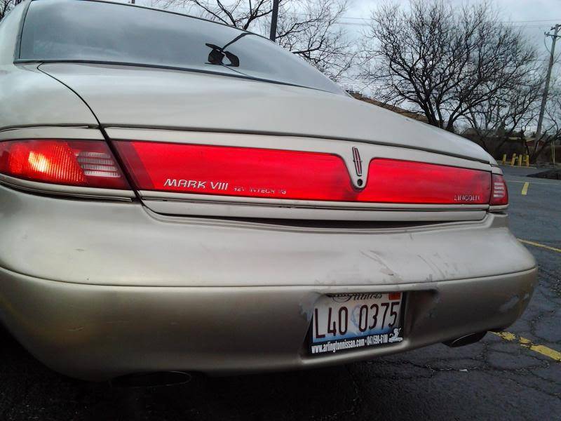

I got a pearl Ivory for my dads Mark VIII to repaint the bumper. I bought a quart but it didn't match, so I sent in a test card. They remixed the paint and now it matches perfectly on the test card they sent. When I paint it, I will post a pic here to update. BTW ONLYTONY, did you get their clearcoat or another one?
