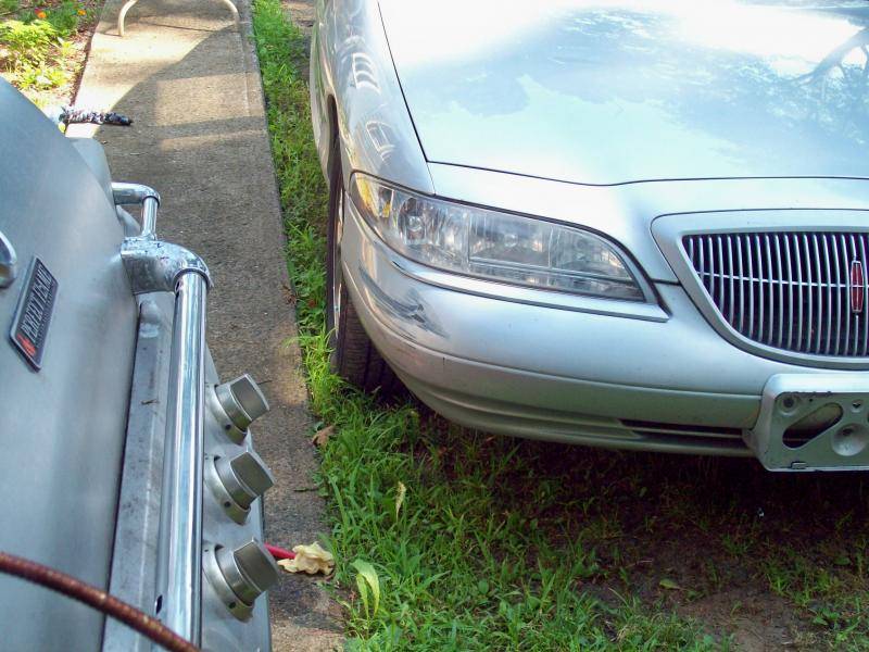

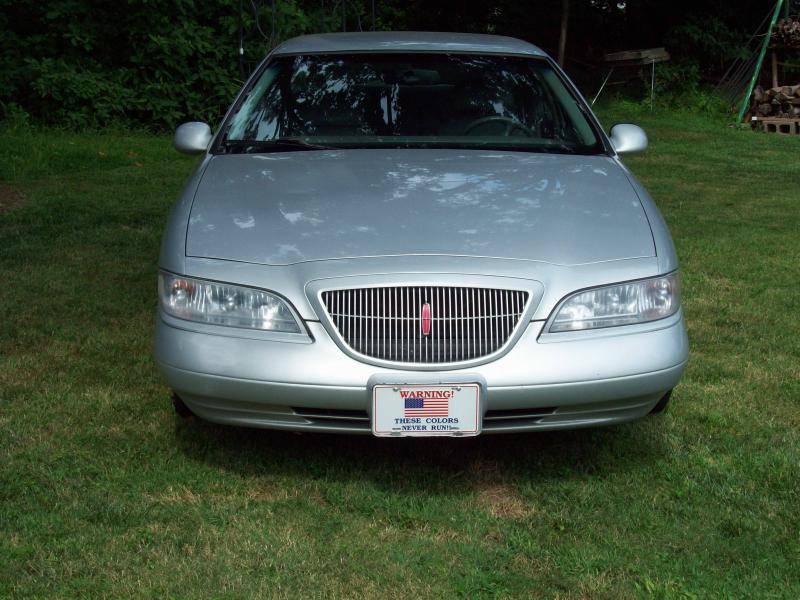

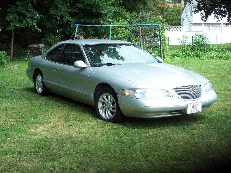

97 sil 4.jpg97 grass 3.jpg97 grass 4.jpgI used glazing puddy for little nooks and crannys. Pics of the silver one
