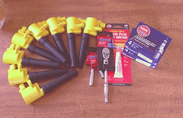

I paired these with the NGK Iridium spark plugs, obviously took care of the misfire, and my engine runs as good as new with incredible response.

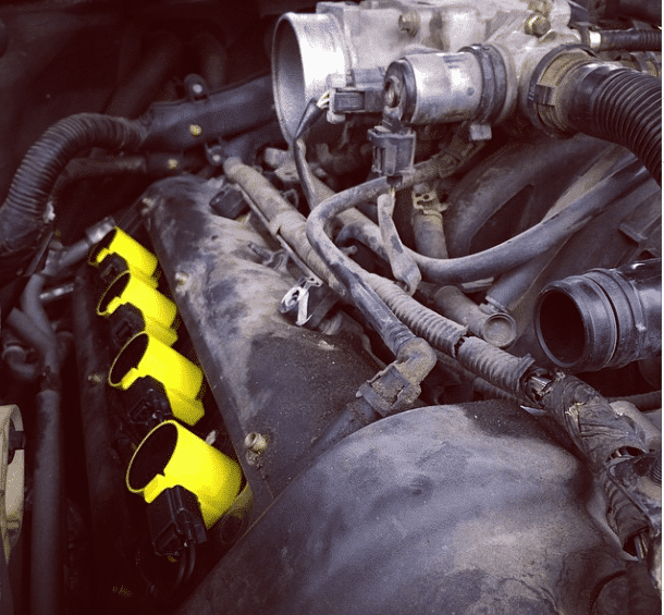

Don't have a lot of pictures of the coils that I took myself but the quality of the materials seemed to be on pair with factory products, and the bright yellow color is reassuring because it looks cool.
My gaskets were fine and this has been a great setup for me since early March now.

^ with a filthy engine like that, would it really matter if the covers were missing?
It's a chinese knock-off. They are supposed to look like an Accel COP just without actually saying Accel on them.
If you are lucky it's a quality knock-off and you'll be just fine. :)
Unfortunately, you can't tell the quality of what's on the inside by looking at the outside.
