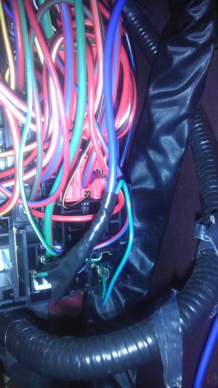

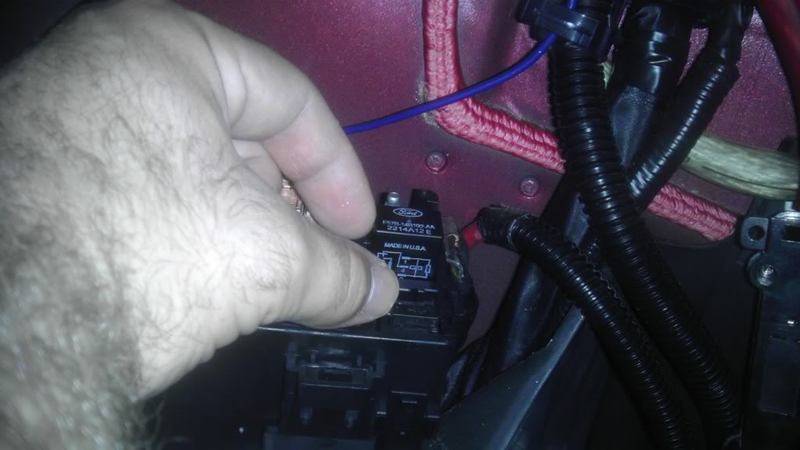

My remote (assuming what you're calling the trigger) is wired to a wire jumping a relay and a diode in the trunk seen below. The wiring is a bloody mess but you may be able to make it out in the pictures. Others will know for sure on what's going on but this is how mine's currently set up. Some LOC's have a remote and you could still use these but the signal would be coming from the door speakers if IRC.
