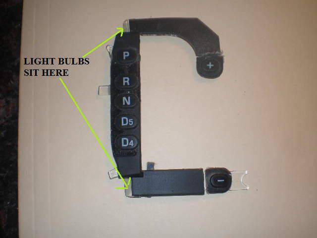

one of my lights on the gear shifter went out,the + sign bulb. Guess I can start this project. How much time was spent taking everything apart. What was needed for the job, I'm guessing your stand screw drivers and probably a soldier gun.
LongislandLSE, the + button is illuminated by the same bulb as the P/N/R/D section.
There's only two bulbs under there that illuminate the whole gear selector. Here's a picture, with arrows pointing to where the bulbs are located when assembled.

pektel, I'll check tonight but that's what jt looked like to me. The + was really dull to hardly even lit. IDK

It's easy to change out the bulbs. I currently have green LEDs in there because as stated before there is a green overlay on the shift letters.

Yes, you pull down the little plastic piece on the bottom of shift knob to reveal a screw. Unscrew it and take off the shift knob. Then you just pull out the center console and once you get to the shift plate you just twist and pull the bulbs out. The lens is plastic green, I put green LEDs in so it is a darker almost more bluish sort of green. I would definitely be interested in a different color though.
The + looks dull because the light has to travel around a curve to get to it. I plan on just tapping into the wires, and installing another bulb directly underneath that part.
Does the Park/Reverse buttons look slightly duller than the lower ones? Then it probably is the upper bulb.
You could probably wire a few LEDS together and hot glue them to the designated spots on the plate individually.
Gets rid of that escaped light or obstructed light do to it just being a bulb for all of them.
yep, the top bulb is out
