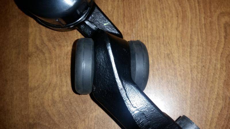

Hi Everyone,
First time changing the LCA and SRB. I searched everywhere and even with everyone's help couldn't find both the front and rear Ford bushings for the the LCA and frame of the car.

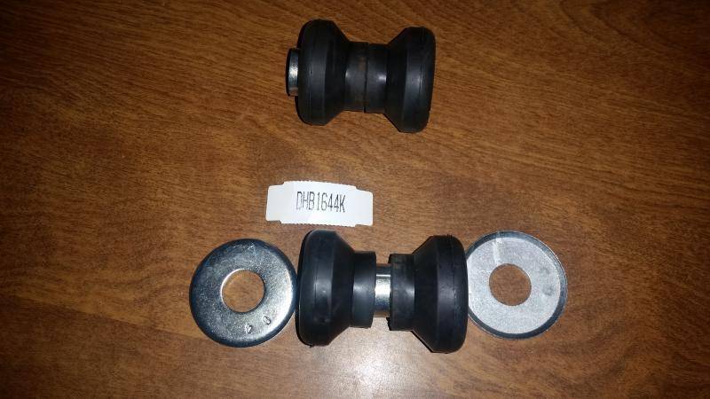

The frame bushings look good, so I went with Duralast for the LCA bushings. They came with the washers and the sleeves.
I have the M8 all apart. I opened the new bushings and all 4 look the same - meaning do not see Front or rear. They look to be different design, but want to make sure before installing these. The pic shows the most outer (what Ford calls the "Rear" bushing) fitting snug to the LCA. The inner bushing (what Ford calls the "Front") fits snug but doesn't seat up to the LCA the way the one closest to the nut does. The LCA does have a shallower/smaller angle on the side farthest away from the nut and this is the one that doesn't seat right up against the LCA. It does fit snug in the hole though...not sure if its a new design or Auto Zone gave me the wrong parts? I showed them the bushings I wanted on their screen.

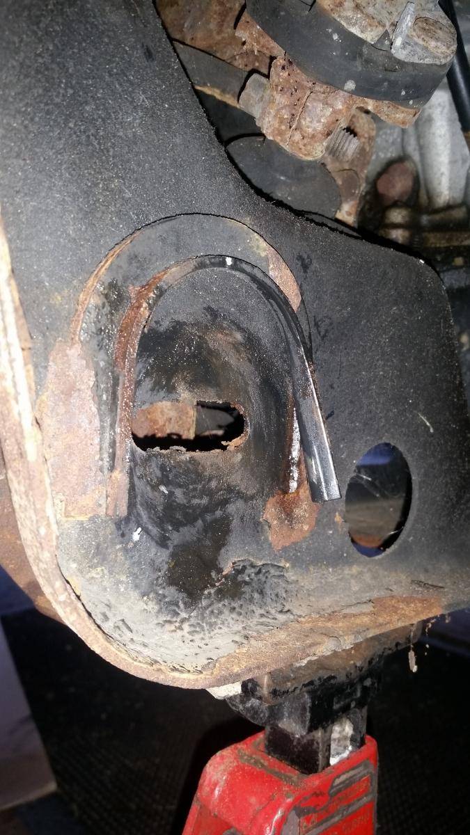

While I was removing the camber bolt, the retaining frame for the camber plate broke.
For anyone doing this be very careful and make sure you loosen this by the nut and not the bolt. I didn't want to chance damaging the inner tie rod boot and with a long socket was hitting the boot. At the time I couldn't find my 13/16 box end wrench.

- Can anyone confirm the above re: bushing? Part number is FA7193. There were 4 bushings, 4 washers and 2 sleeves.

yeah, those bushings look correct.

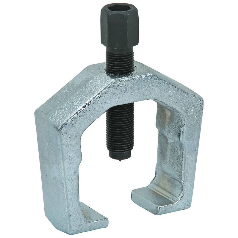

you can try either a pickle fork, or a pitman puller.
it's been a while since i've done this, but i remember having good luck with the pitman puller.

Re: bushings do I use the washers the same way as Ford - cup side facing away from bushing? These look like they cup should face the bushing. See pic above.

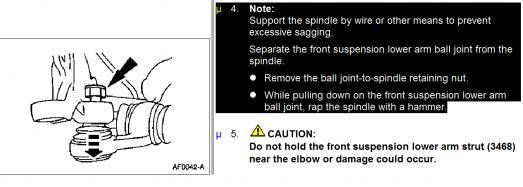

The Ford manual doesn't mention any of the three, see pic.REmoving LCA ball joint -Ford manual.jpg

washer cup facing the bushing is what i did.
so opposite the oem ford set up.
interesting. i could see that working with a big f'ing hammer.
trying to think of a way to pull down on the arm, they seem to have glossed over that bit..
Yes I think they did a tad!
Just got it out now...wow.

I also put a call into Pepboys about the SR bushings and they couldn't help. I noticed Acdelco has the same style so I emailed them for confirmation. I think Chris is right and the cup side for these bushings should face the bushing, unlike the Ford org. style.
Chris you were right. Here is what ACDelco has to say:
"Good Morning,
Thank you for your inquiry. Based on the information that you provided, the washers should be cup side to the bushing.
For future assistance, we suggest you contact the location where you purchase your ACDelco products.
Thanks for your support of ACDelco!
ACDelco Info-Line"
