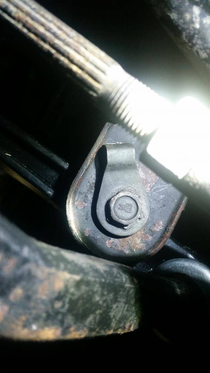

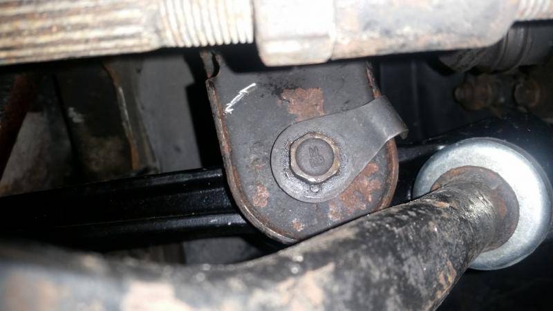

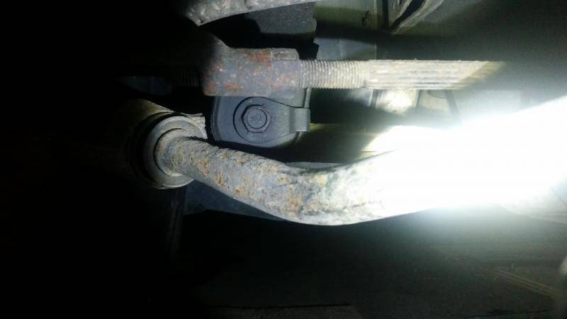

One question: the shock bolt hook goes on the outside of the shock arm, correct? The one on the passenger side was on the outside and I didn't notice but when I tried loosening the driver side it moved. I will upload pics shortly.
here are the pics for my question above. I believe it should be as I installed it last pic (same as the passenger side) Hook/clip on outside of shock connector.
The first pic is the passenger, the second is how driver side looked once I started to remove it (you can see the scratch from the bolt hook or clip). The hook/clip on the inside.
Just want to confirm the hook/clip should be on the outside. That is what makes sense to me.

yep, outside.
supposed to be so that you can just tighten the nut, and the projection holds the bolt head in place.
