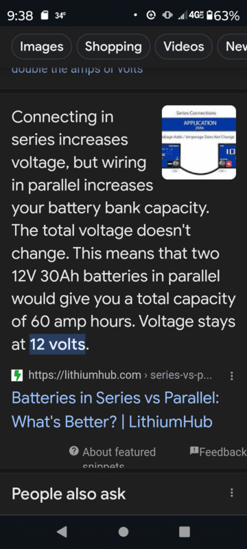

I'm not super well versed in automotive charging systems, but wouldn't adding another battery create additional load on the alternator? My plan at first was to do that, but I see people saying it does, some people say it doesn't. So I guess a follow up question would be: Can my 110amp alternator handle charging two batteries and keep up without dropping voltage or anything weird?
