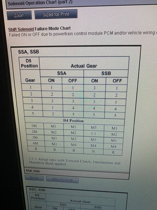

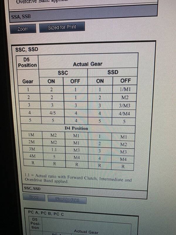

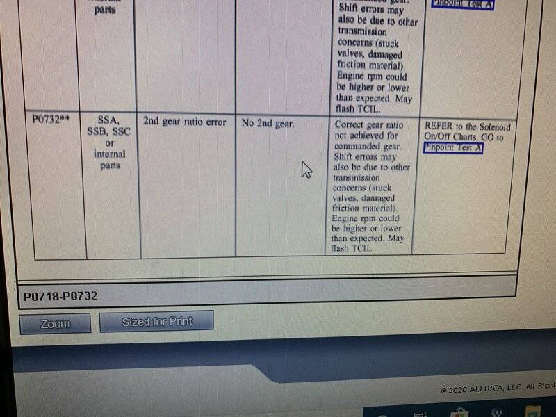

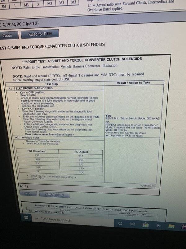

Here are the pictures. Obviously I have no idea what I’m looking at for the most part lol not sure what SSB, and the rest mean. I assume referring to each solenoid and their state.
