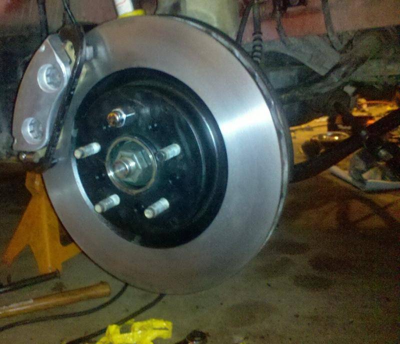

Couldn't find any good pics, so here's some mediocre ones...
That's a bad bich
