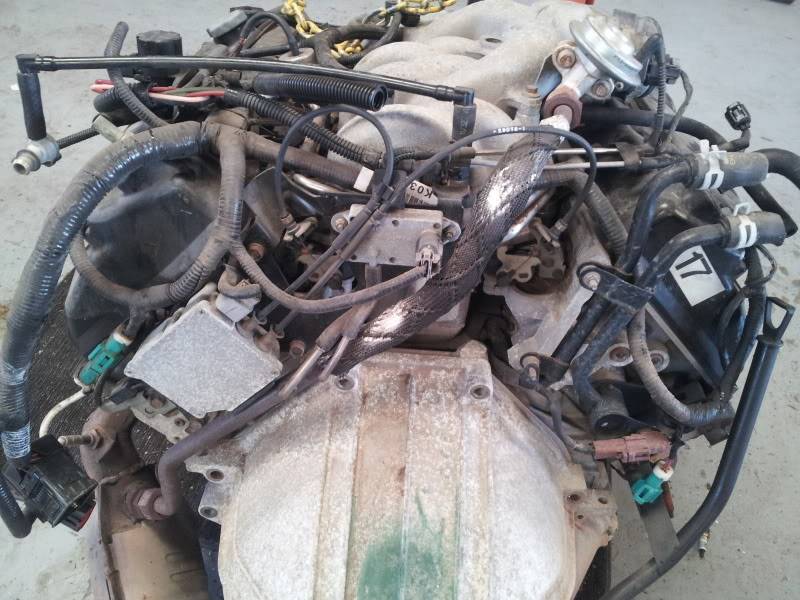

This is the backside view of a 2nd Gen engine, you see the 2 cables that split and connect to the lower side of the Plenum. Where the cables connect are the Manifold Runner.. your car won't have the square module like this one, it'll have 2 black "pepper shaker" looking modules with a plug on each
They open the secondary intake valves for each cylinder.. if stuck open you're In a lean condition

Looking at the back of the engine, I am assuming that you are talking about the retangular box on the left rear side. It has two cables running up to a mechanical selonoid on each side. If I am correct, it appears that it is operated by mechanical means without vacuum. Am I correct??
Both look like a PITA to access.
