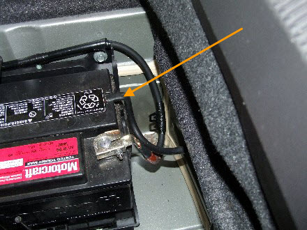

Should be a rubber tube hooked up to the side of it. If not, I would look into corrison of your fuses. Also your car can blow up so get a proper battery.
That's freaking scary. I'll be getting a new battery tomorrow, that's for sure. Just looked there's a tube from the car but no place to for it to hook up to the battery. Does it hook up to the battery? I've never had a vehicle with a battery in the truck, so it's new to me
Yes, there is a little port on the side that the tube will hook up to. Your battery has been venting in your trunk, this is very corrosive and does have the possibility to explode if there is a spark. I would start pulling fuses and looking to see if there is some corrosion causing the intermittent starting problem, and test relays.
vent tube.....
