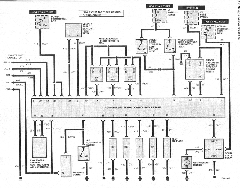

wiring looks like this.
so if you turn off the switch and the computer cuts power to the compressor, i would say the relay is good.
i vote sensor wiring issue. the car thinks it is siting too low and is trying to go up. check your wiring. the sensors don't usually go bad.
Hmmmmm…. thank you Unity and Chris. Both answers seem to make sense. I can see the switch being able to overtake the relay.. .for two reasons: 1 the switch in some way reports to the module, which may somehow turn the relay off, and 2.... there are no messages popping up on the message center that state any problems regarding the air ride system, and I’ve checked and double checked the wiring the colors match up...I could be wrong though so I will check again! Also Chris you mentioned the height sensors which also makes sense....cause it does seem that the relay is hot at all times... if it were stuck engaged the switch would have no effective changes to the relay...so it seems. With that said I will check the relay first, only because for the coast of nothing I’m able to swap it with the abs relay....If that fails I will have to order new sensors and try that out. Thanks again everyone! if anyone has any alternative ideas I’m not opposed to hearing them!!!!!
